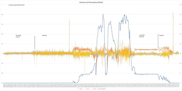

I own a Sea-Doo GTR230 that I have had back for service for a bad idle vibration on a number of occasions. BRP sent one of their technicians out and I was told he worked on it for 2 days with no resolution. I have contacted a number of Sea-Doo dealers in Australia who have advised that the supercharged models have this vibration problem that can’t be fixed. The only way to get rid of the vibration is to accelerate to 30 mph. I had the vibration start in a 4-knot speed zone and the only way to get rid of the vibration was to accelerate to 30 mph (26 knots or 48 kph) in a 4-knot zone. I contacted BRP who refuse to contact me directly, and they emailed “After investigating the dealer's case, they have suggested that the vibration will decrease with a bit of acceleration.” So BRP are advising a person to speed in a 4-knot zone to get rid of a problem that BRP refuses to fix.

Good luck with the servicing. My dealer denied the ski had any problems until I glued my mobile phone to the Glove Box Cover and recorded the vibrations with the Track Addict app. They then tried a number of fixes, none of which worked. They then got a technician from BRP to spend two days trying to fix it and his attempts have only made it worse.
