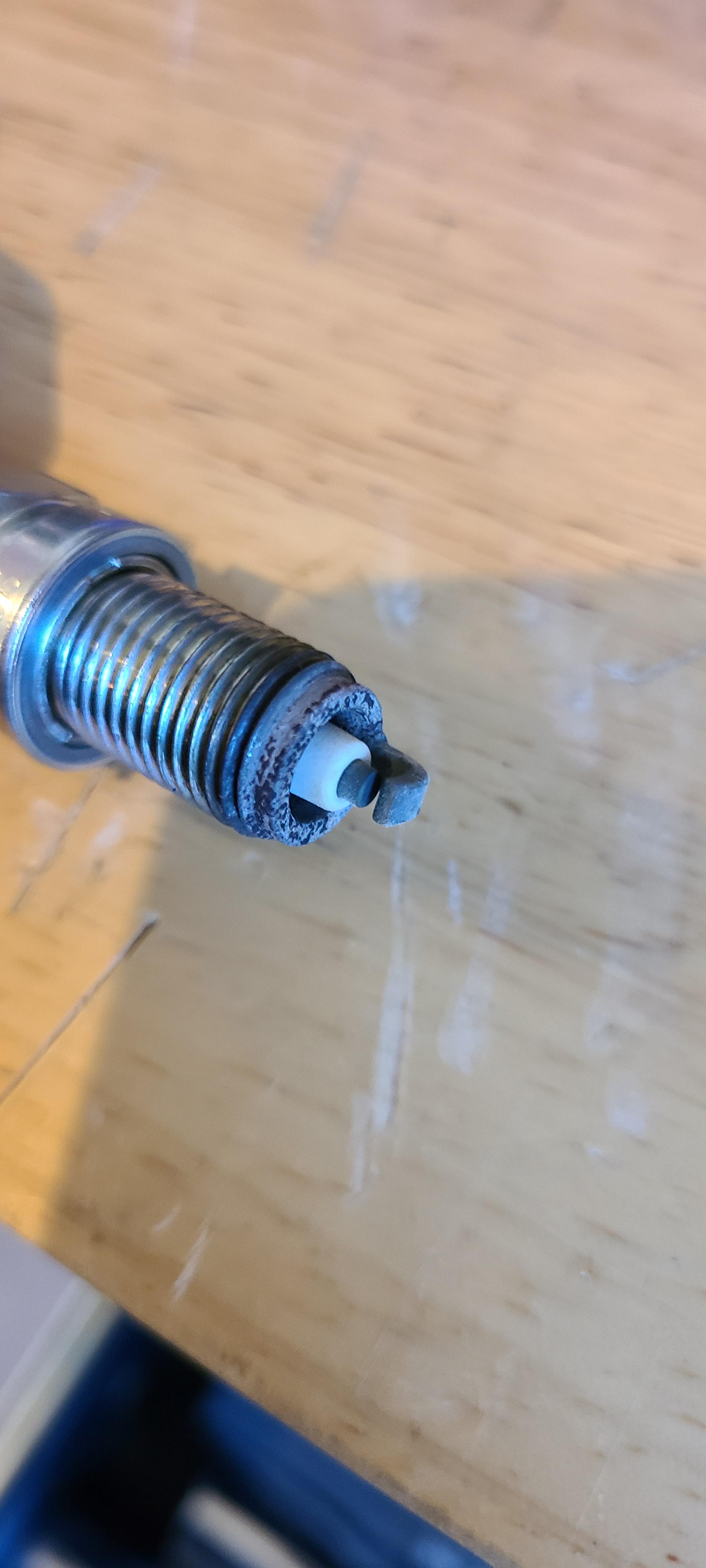

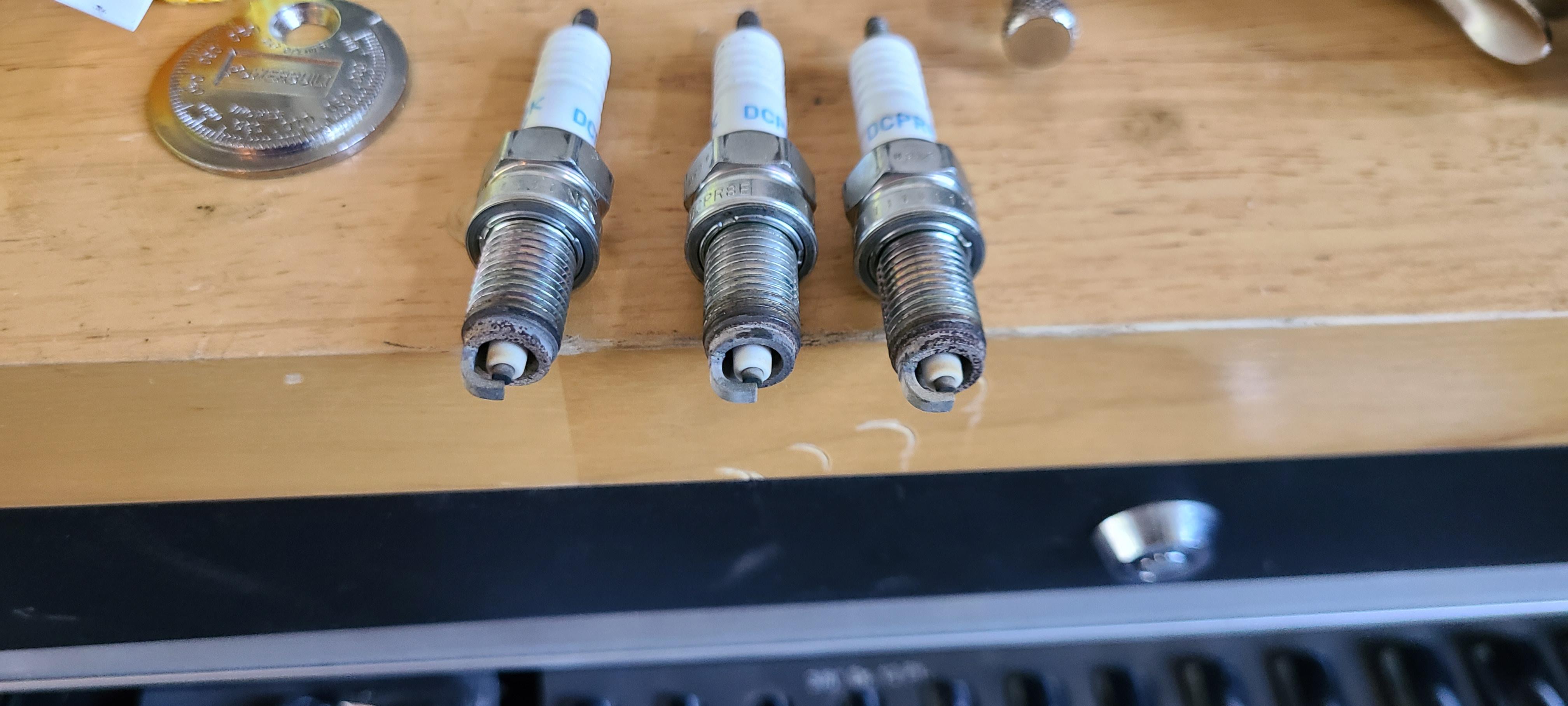

Just for reference here were the old plugs with 25 to 30 hours. Basically textbook perfect.
