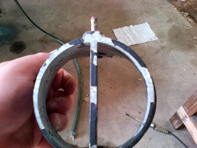

Has anyone been able to fix something like this on the steering nozzle? Or does anyone know how it was attached to begin with?
Thanks in advace
Sorry my mistake just purchases a 1997 Seadoo Challenger 1800 I will update the signature.
This is where the steering rod attaches from one nozzle to the other.
I assume Cast Aluminum, What do you think the chance of cutting it off flush drilling it out and tapping then epoxy a 1/4-20 back in?
Well... as I recall... that should be a threaded post. (for the cross link)
Ummmmmmm........
I would probably cut it flush, and then drill/tap the nozzle for a new stud. You could use a length of threaded rod. Then thread it into the nozzle, and put a stop nut on it. AND... use plenty of red thread locker. Once cured... put the cross link on, and a new stop nut.
It may wind up being a little longer, because of the stop nut... but I doubt it would make a difference.
