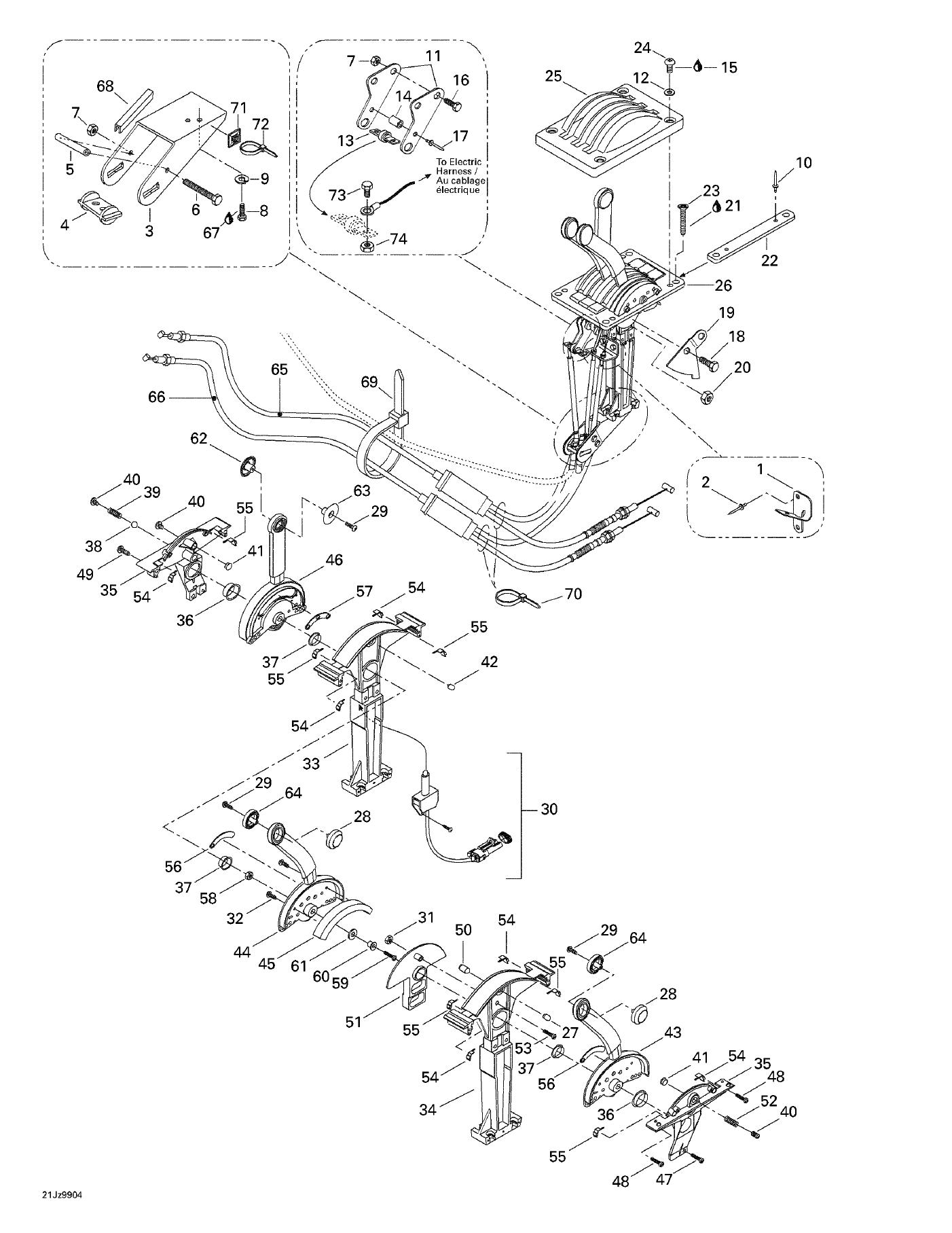

here is the set up for a 98/99 speedster. If you look by part #1 ans 2 you will see the block on the throttle cables with the extra cable pull that hooks up to the steering mechanism.
98/99 Speedster

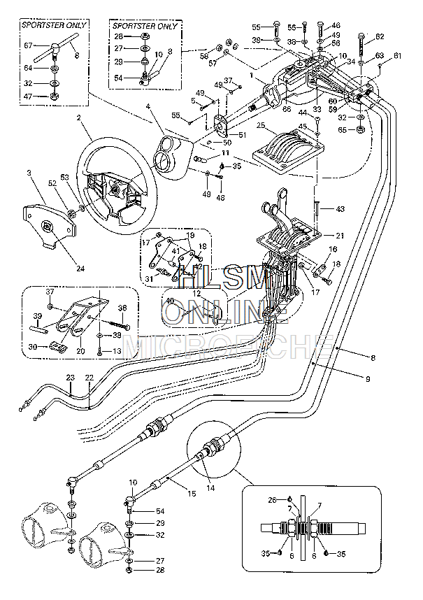

95 Speedster
