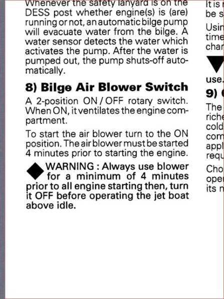

I was reading through the operator's guide and it said that one should wait 5-10 minutes before starting the engines. Is this something that is normally done? I was raised on the lake and the boat that I rode on, the motor was always shut off when someone got up on the back and then started right back up when they were inside the boat.
