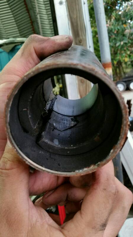

This is what's wrong with mine, the magnet plate broke and dragged the armature windings. Windings are good, but it slowed it down enough the bender wouldn't come up.
Yep,, that would do it,,,
I would recommend you by a brush kit at the same time. Replace them now and get some quality life out of it..
