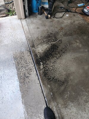

I seeking some help before I end up taking it to a professional. I purchased this 97 SPX back in August. It originally ran fine, but then it began to have issues running to rich and flooding. I took the carbs off and rebuilt them, thinking this could be the cause. I rebuilt the carbs, check the top off and reinstalled. Now the ski will start pretty easily, but the idle is high and continues to rise on its own until I shut it off and I noticed oil/water mixture from the exhaust. Did I rebuild the carbs incorrectly? Is the crankcase leaking? Any help would be appreciated, thanks.
