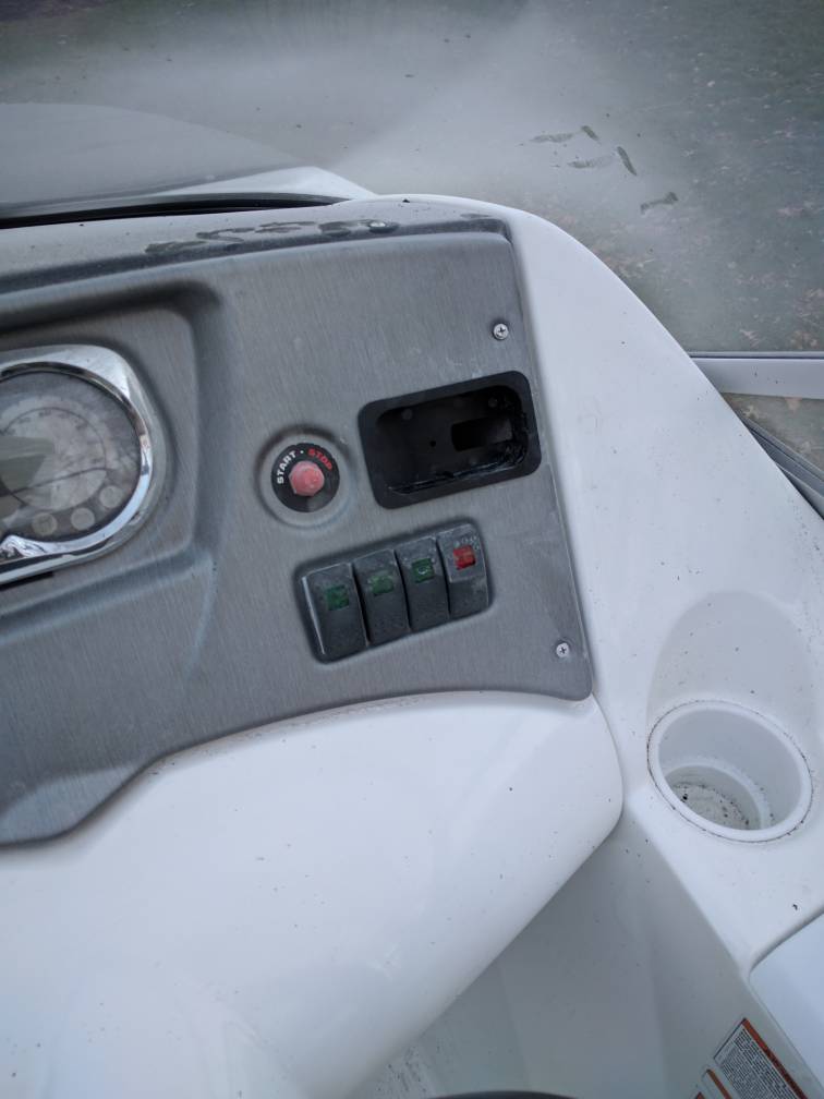

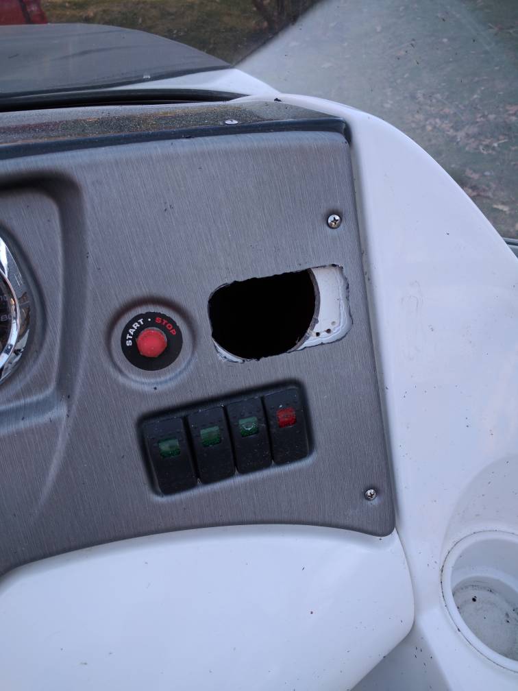

Here is a picture of the progress I was able to make yesterday:
I was able to cut the mounting hole for new receiver and drill out the speaker holes for the bow of the boat. More pictures to follow...

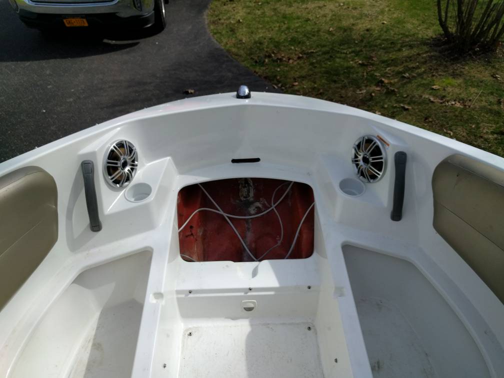

So I was able to run my new front speaker wire from the glovebox where the other wires are to the new speakers up front! I used fish tape and the process was way easier than I anticipated. No drilling was necessary to get the wire all the way up there.

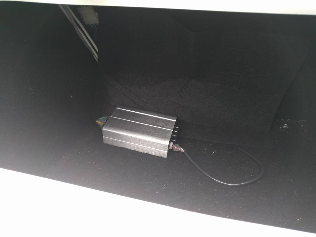

Currently I just have the amp in the glove box. Tomorrow I am going to make an extension for the dash remote and mount the amp in the glove box as well as hide the wires. Thanks for looking.

Last projects for the speakers are to somehow hang the wires that hang in the center of the bow. Does anybody have any good ideas for this??? I need to get these up out of the way so that they will not snag on the seats up there.

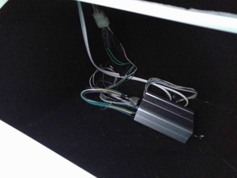

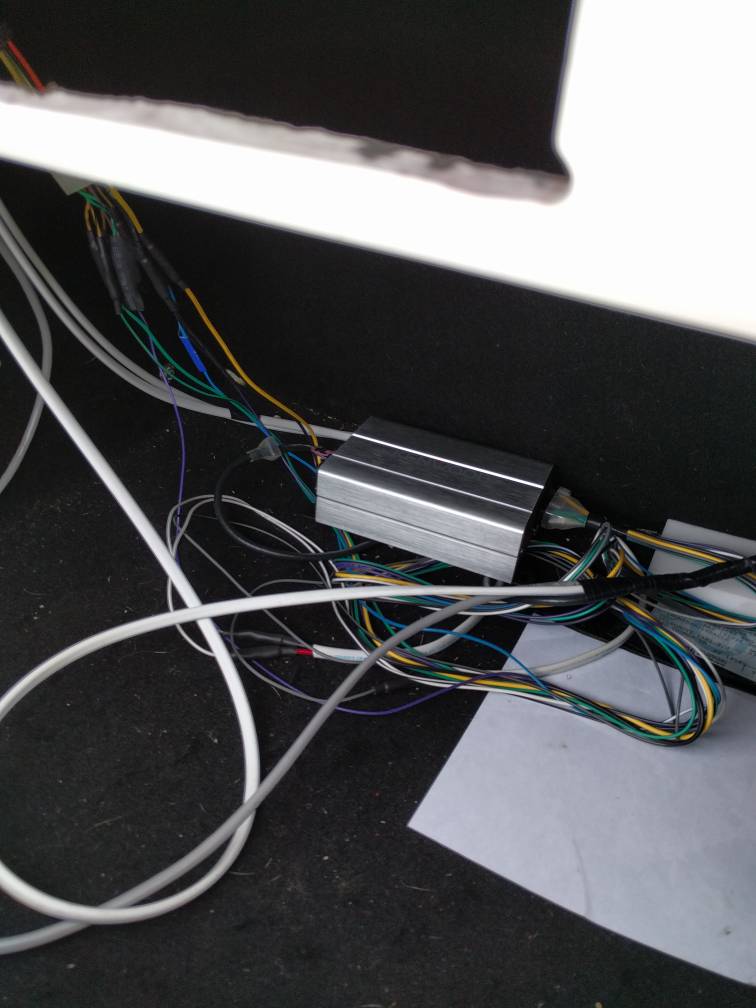

The final project is to organize the new wires in the glovebox to the new amp. Does anybody have any input here? (This is not actually as bad as it looks. I was considering organizing the wire and then finding some more black felt to put on top of the wires to make it disappear? ) Please help

Yesterday I did my best to hide the wires in the glovebox. I used a piece of felt that I ordered on Amazon and ended up seeing some Velcro on to secure it in my glovebox.
Here is the before:
Here is the after:
It still needs some minor finishing touches but I will do that out on the water some lazy Sunday!
