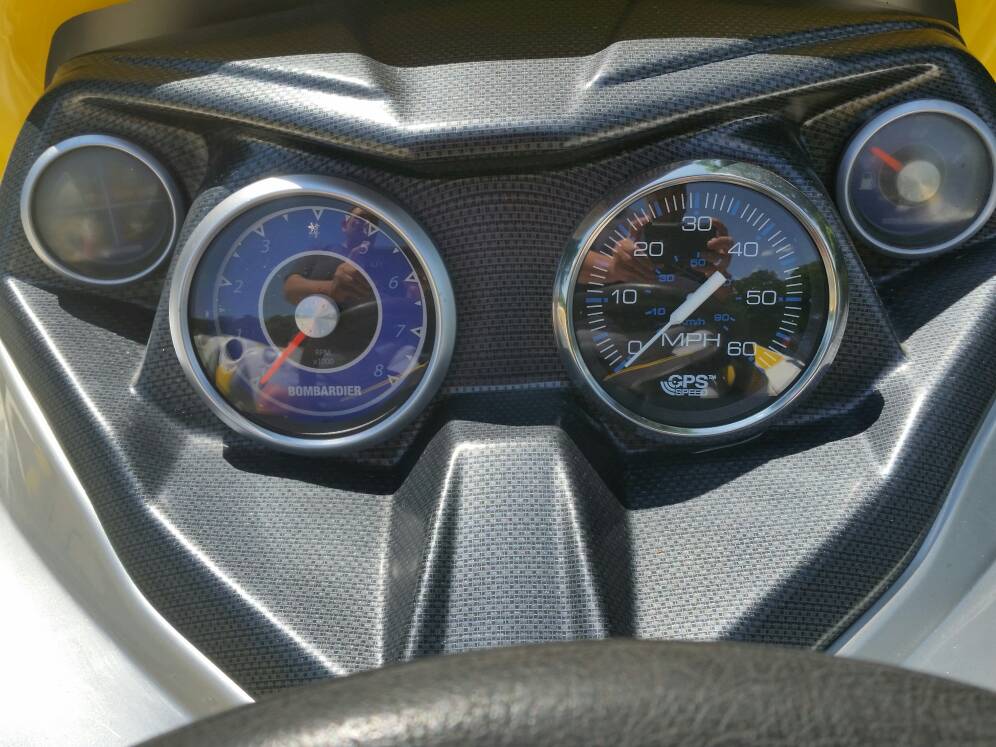

The speedo can be repaired at Faria. The cost is $100 plus shipping. I just had my tach done and it looks new.
I also put in a Faria GPS speedo that has the receiver in the gauge. Paid $90 no tax free shipping from Cabelas. Fits into the same hole.
What did you to "re-do" your tach? and do you have a pic of the new Faria speedo installed? How much work is it to install?
Here is a pic of the repaired tach and the new GPS speedo.
The speedo is a direct fit and uses three wires. 12v from the ignition, ground and 12v from the battery. The 12v ignition already exist with the ground all I added was the 12v from the battery so the GPS turns on fast and remembers the signal.
Ok, gotcha! My cluster is all integrated on the Speedster 150. That puppy is much bigger than I thought. What ride do you have?
