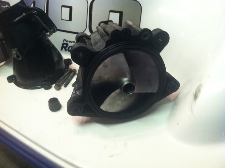

I pulled the pump off the boat, and took the driveshaft apart as well. Was a little disappointed, I was hoping to find a messed up impeller, wear ring, and carbon seal. Unfortunately they all looked like they were in decent shape. I did have a bunch of cavitation though so we will see what happens when I replace all the parts tomorrow
Stupid questions, the impeller is reverse threaded on? I didn't try taking it off yet.
Is the driveshaft guard necessary? I guess someone has been in there before because it was missing, well most if it. Perhaps it helps cut down on turbulence from the shaft spinning? in the intake area.

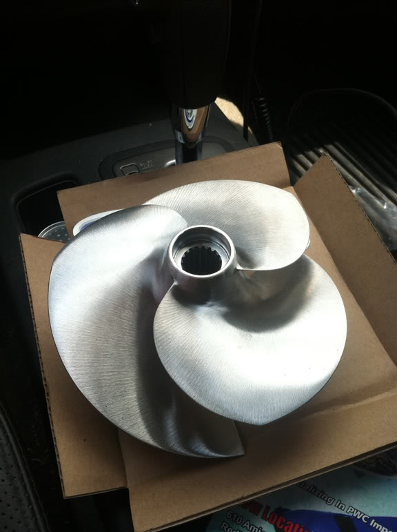

New Skat Trak swirl recommended by the Dr. Impro's set me up with a 13/19. Not sure if thats good or not lol
Jet pump off
The swirls are nice impellers. I have them on my Sportster 1800. You will tell the difference it gets faster on plane and in the turn the pump stays loaded much better. Only in real rough water I get a little cavitation turning. Heck I can do a 360's now wth my Sportster 1800 with the 2 smaller 717's. I replaced the Carbon Seal assembly's also when I did my impellers just because my boat is 14 years old. Most people remove those drive shaft guards if they break they can messup your pump, impeller, or wear ring.
Howie099 I also have the 1800 and want more bottom end power. Did you find a big difference from stock to the skat trac? Give me some details thanks!
Yes I have better whole shot. I can spin the big boy in a 360 and pull right perfect the 3 people in it. With very little cavitation. I don't get the weeds all stuck up there now either the swirl pretty much chops them up good.
I've put Skat-Trak swirl impellers in all my toys over the past 10 years. It's the best "Recreation" impeller made.
Thanks for the reply guys. I've read a thousand forums on here and dr. Honda your a helpful guy! I'll be ordering myself a set for sure!
