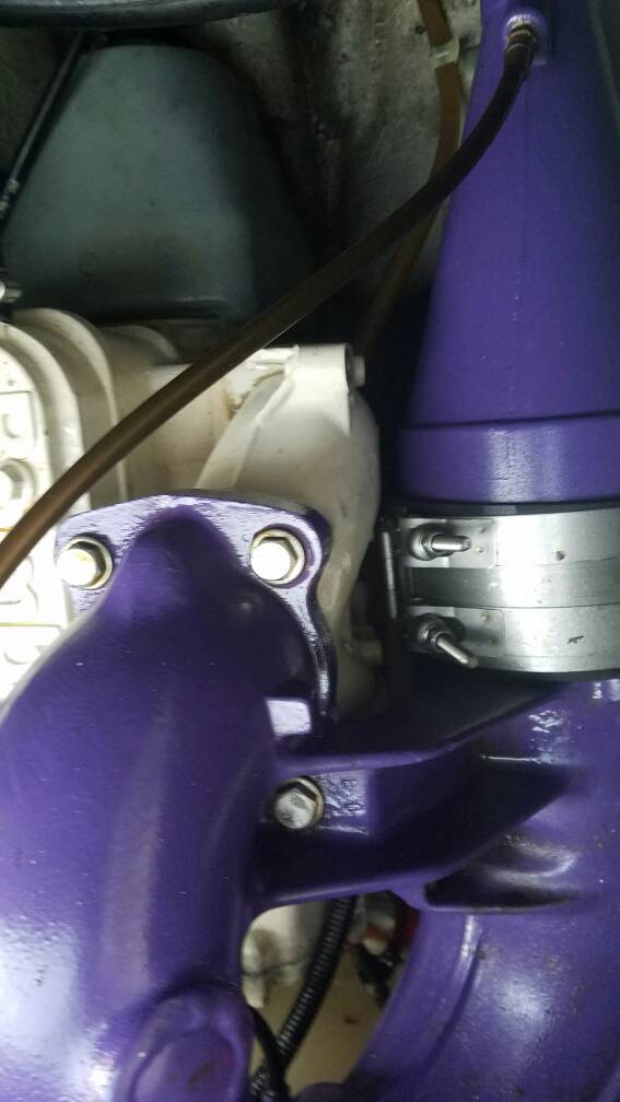

Also the one of these bolts in the pic seems to have a very very slow leak coming out around it. Should i take it out and put some sort of sealer on it and back in ?
You can't seal the bolt. I would remove the exhaust, change the gasket ( possibly adding some gasket sealer designed for heat) and rrebuild it.
Andy
You can't seal the bolt. I would remove the exhaust, change the gasket ( possibly adding some gasket sealer designed for heat) and rebuild it.
Andy
I have replaced that gasket more than once. It's 4 bolts and 1 nut, hoses off, and out comes exhaust. you may not have to remove it from the engine bay just turn it right to expose the exhaust manifold, then replace gasket. There are black "asbestos" looking gaskets, those have never failed me. There is an orange kind that failed on me once.
(I boat in brackish water and mine have leaked due to the exhaust rusting off at the round solder points, and I also have removed and replaced for Stater replacement. A few times too many :) )

Get new bolts and lock washers !!! Get a new OEM gasket !
Take it apart, and make sure there isn't any big gouges in the mating surfaces, or a crack in the parts.
Normally I put the gasket on dry... but a coat of "Spray Copper" is OK. ONLY TORQUE TO SPEC !!!!!!!!!!!!!!!!!!!!!!!!!!!!!!!!!!
OK... here's the deal...
With the exhaust... if you have issues with a leak, or bolts coming loose, there could be few problems:
1) If you over torque the bolts... you will crush the gasket. Also, you will pull out any "Spring" in the bolt. So, when it gets hot... it will expand, and in turn REALY crush the gasket, and stretch the bolts. Then... when it cools, it will all become loose, and on the next start up, the bolts start to vibrate out, and the gasket will leak.
2) Once you've stretched the bolts... they will "Work Harden" and will no longer have any spring to them. (for normal expansion) So... even if you clean things, put in a new gasket, and properly torque... you will still end up with a leak, and loose bolts.
This is a very common scenario with watercraft. (and other engines) The mechanic (or owner) will simply swap the gasket, and then over torque the bolt hopping it will hold the next time. In reality... it won't, until new bolts are installed.
Oh... FYI... don't put any thread locker on the bolts. They are normally hard to get out anyway. I only assemble exhaust parts using anti-seize.
