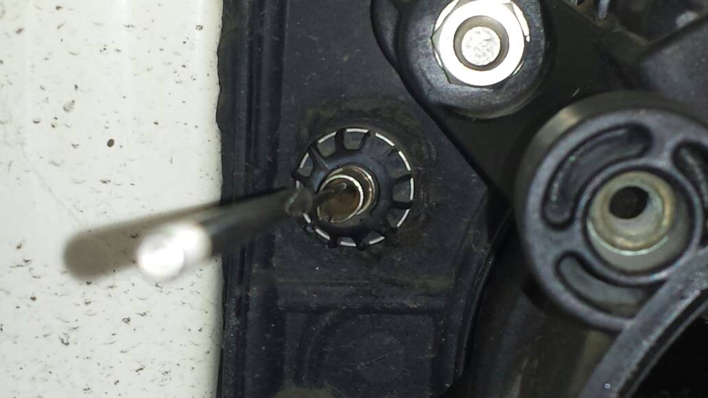

Trying to remove the reverse cable on a 98 speedster. Everything is loose up front the back I got the big nut off inside the hull. Question now is what else needs to happen to get it out. Does the plastic nut piece have to come off on the pump support?

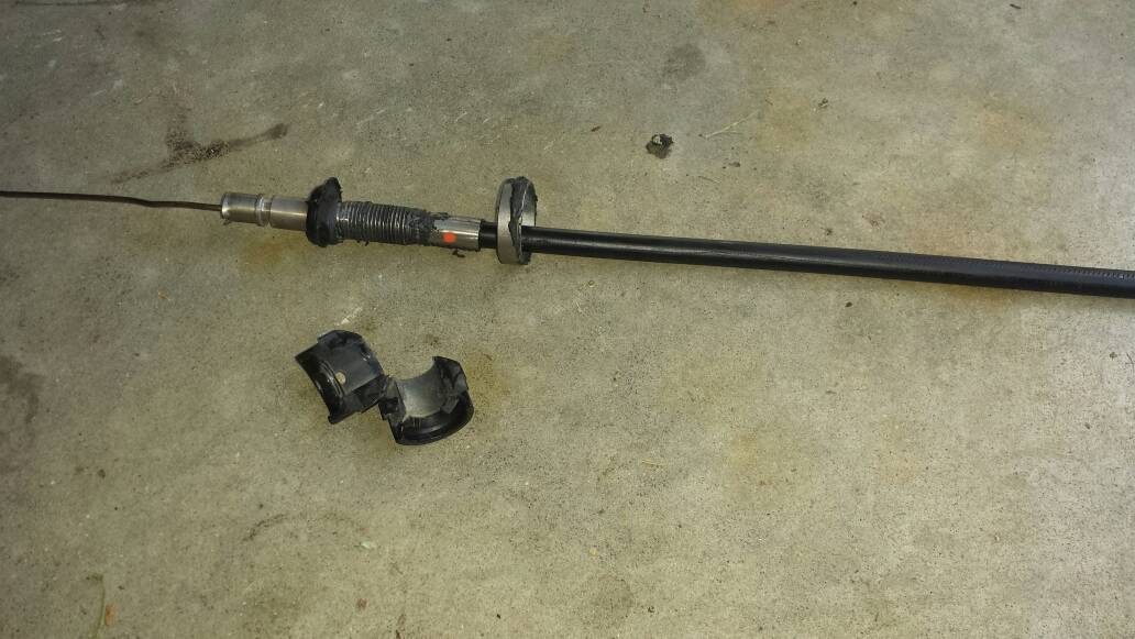

It has to go out the back now. then the black plastic pieces will separate, then the stainless ring and seal. If the cable is junk you might have to cut it and beat it out of there. I just went through that with my steering cable on my XP resto. The carefully clean the hole up with the appropriate drill bit. I greased the threads real good to hope that if I ever need to pull it I can easily. Order a new seal for it too, or chance using the old one.
Dang your fast. So I push the cable out towards the rear of the boat and that nut should split ?

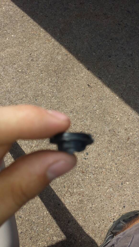

Lol, got it out, but that nut just isn't falling apart. If I pry it will it break ?

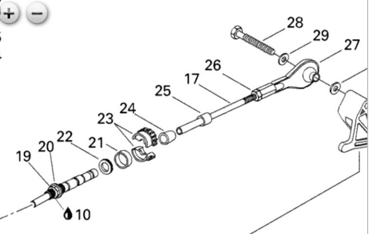

The seal suggested to be replaced, do you happen to have a part number? In the diagram on either side of the split nut, it lists the rubber washer on the inside or large boot on the other side. Is the large boot as they call it what we're referring to as the seal? Part #24?
Yes sir.
New cable in with nut from the inside, then the rubber washer (#22) from the outside, then the two black halves clip into the groove on the cable housing, then the stainless ring holds them together and clipped into the groove. Then tighten the nut from inside and the black plastic draws into the rubber washer against the hull cinches around the housing and forms into the hole a tiny bit. So simple, yet you would think you need something so complex!
#24 will seal the the cable to the black plastic on the front side. I'd have to check my Speedster.

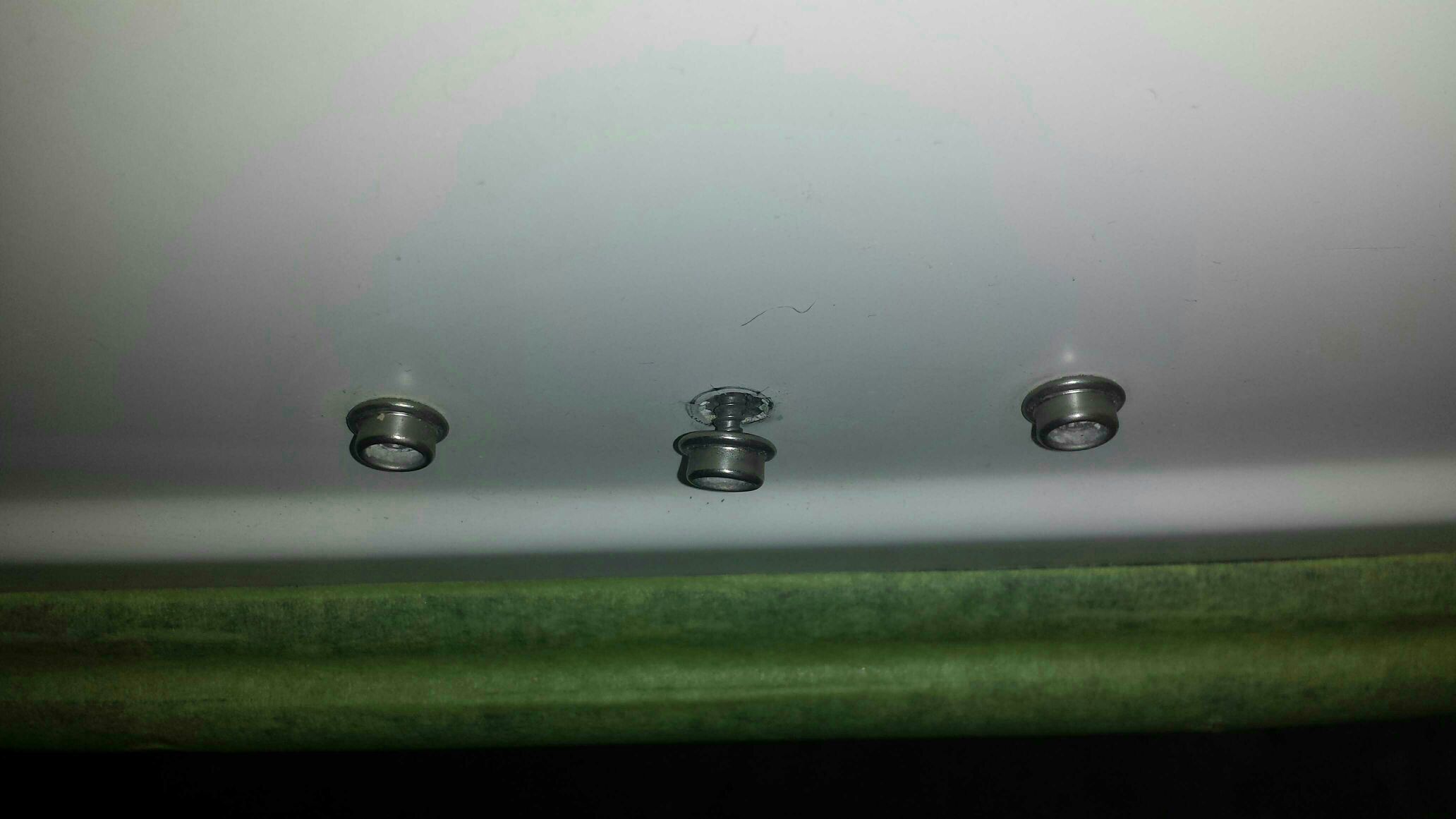

On another note. What do these go to. Was giving it a wash today and one of the screws is just sitting there.
