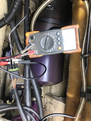

Do the test. Pull the bayonet plugs out of the the first connection in the back of the ski and plug them back where they go. Then connect a volt meter to the power and ground wires (picture shows the 2 outside terminals on this ski). Tan wire is the water temperature. Push the start/stop button and if the system powers up you should read around 9 volts and as you turn the little wheel the voltage should drop to 5 volts or so. If the drop is not pronounced enough the gauge will not read or respond and they sensor is DEAD.
You also have a speed readout on the INFO gauge. If neither gauge is reading it's probably the sensor. I bought a GPS type from Candoo. I'm currently have problems with it on and Dennis is gonna take a look at it. I have a 2000RX also.
