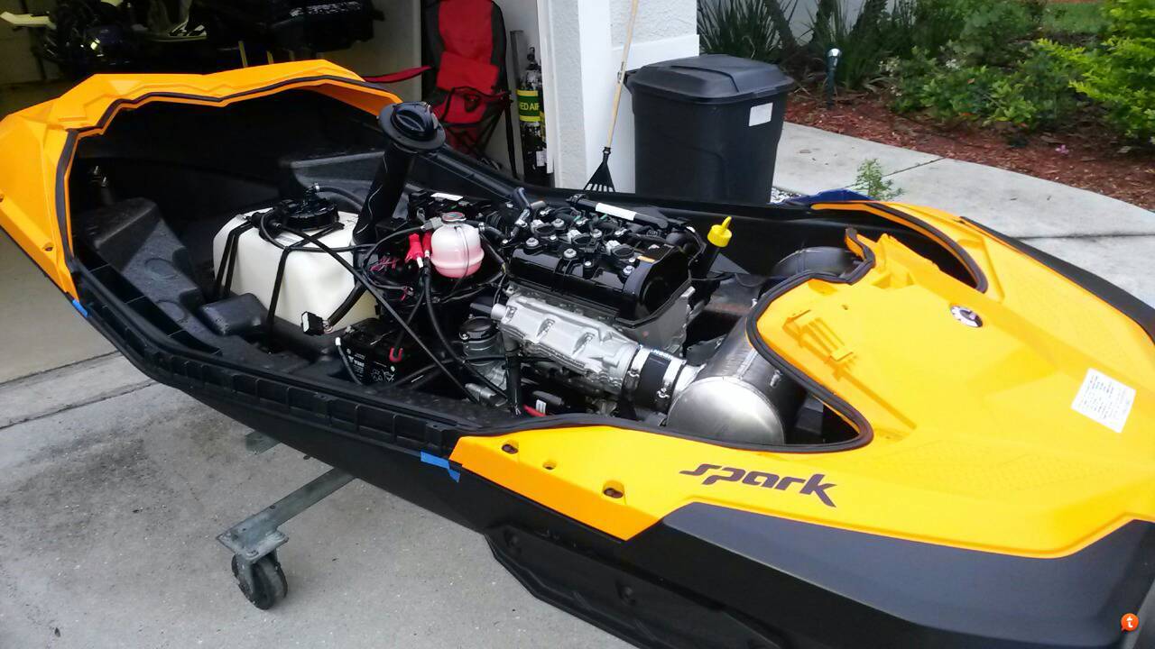

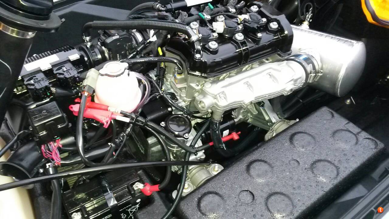

Im taking the top deck off tonight. I just want to check everything before I get all the way to the water Sunday.
With as light as the sparks are, it may be reasonable to carry it to a pool and look for leaks where the water is clear and shallow enough for you to stand and look for air bubbles and get a better inspection out of it
Its always better to fill the hull with water and look to see where it comes out. I ran it on the flush with the deck off. No leaks. Filed with water. ... no leaks. Checked deck seal .. looks good. Re testing Sunday.
