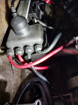

Which spark plug wire, 2 spark wires far right out of rear electrical box, go closest to mag side, manual diagram not quite showing see pic
One should be longer than the other, longer is the MAG.
But the 717 is a wasted spark engine so the both spark at the same time and will run even if you get them mixed up.
