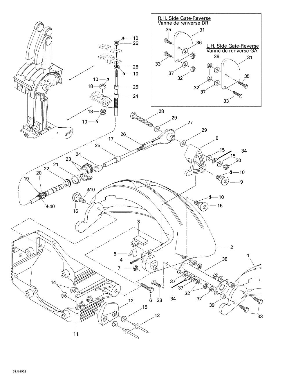

I would check the reverse gate, make sure both springs are attached.
no springs Lou, the port and starboard buckets are attached thru a horizontal tube, and the forward/neutral/reverse shift cable actuates the buckets from the Starboard side.
Would that be part #5 Lou?
Oh... I see
the jetski reverse gates have an actual return/assist spring hooked on 2 posts to help retract and lock the reverse bucket.
our boats have that catch/lock assy. if that were to break or wear, both buckets would move, not just one bc they are tied together thru that tube. usually #12 (pawl stop) in that diagram wears down to where it is not effective.
have a look at page 273 in the service manual.
