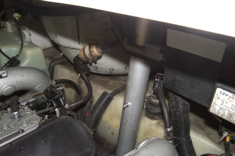

This pic is shows the set screw(?) in the engine compartment. There is an allen head on the screw.

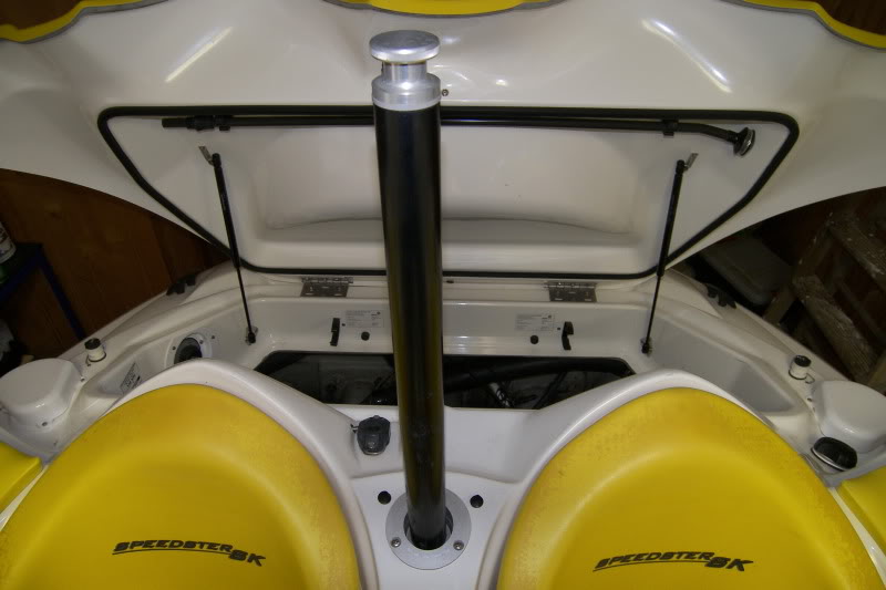

This is fully raised. It has some play in it, not a lot but it does have some. It does not go back down easily. Takes some pushing. Turning the top knob does not seem to make a difference.

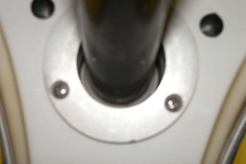

There is a plastic ring/seal? around the black pole.
