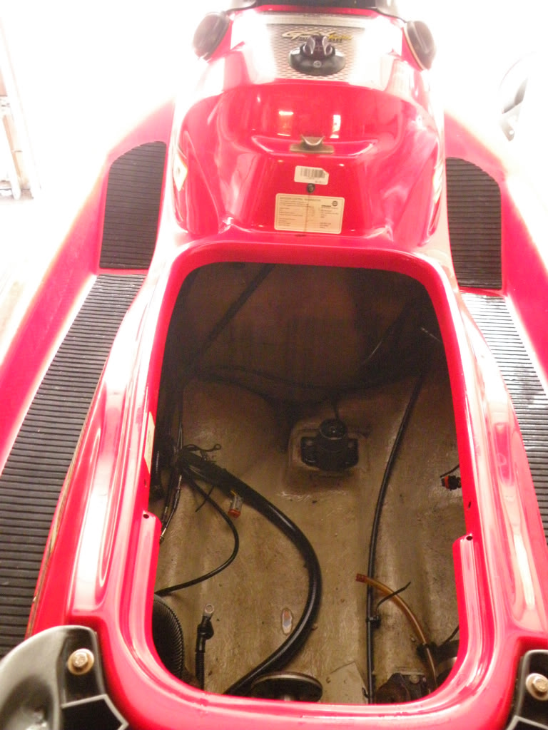

Just had a few minutes today, popped off the seat, and after sitting for a few days now there is about 1/2" of oil sitting in the bottom of the hull....WTF...I'm guessing something is going on with the pump

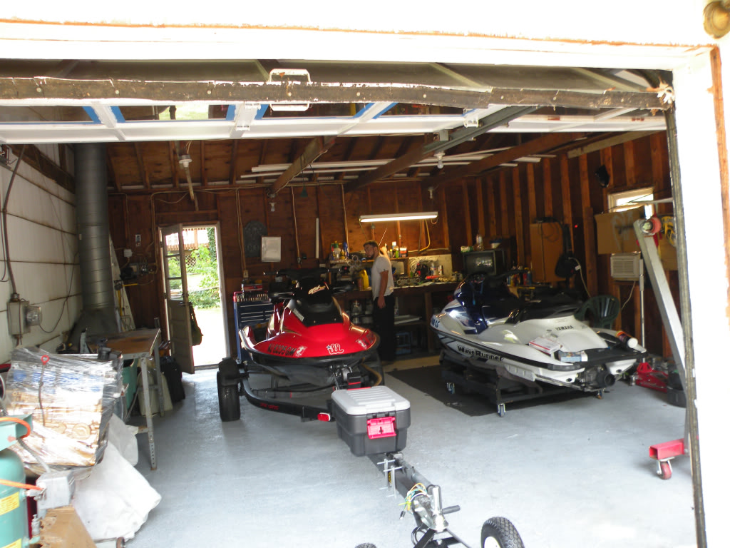

Ok, finally got around to wrenching on it....pulled the motor today...the entire hull was filled with 1" of oil..the 1/2 tank that was in the oil tank fully emptied out while sitting for the last 2 weeks...from pulling it a few miles on the trailer, then it sitting, then moving it from one trailer to another, then into garage, needless to say there was oil everywhere...it's difficult to see where its coming from...all lines were connected, and I pulled the tank itself and there are not visible holes or cracks..
The main feed line (from oil tank to motor) was in place properly..I thought I was going to find this to be obviously broken, off, cracked..something...it also still had oil in the line...it goes from the tank to the line to the filter, to the line into motor.. the closest part of this line to the motor still had oil in it and didn't seem to be leaking...but this was also the one line on the whole ski oil & fuel system that I did not replace when originally putting the new motor in before...the cable was also still moving freely and nicely with the touching of the throttle....where the hell could this oil be coming from? Bad seal on the pump? Bad seal or gasket some where else?

Also looks like the seal on he oil tank where the line comes out is bad and that's where the leak is (I think)
Should this grommet be able to spin? Cus mine does and that doesnt seem like a tight seal it can move

It wasn't done at a dealer or real shop, it was done in a buddies garage...legit garage with all tools and no how but we just over looked a few things i guess that should have been replaced that were not...like the grommet on the main feed tube of the oil tank...almost everything else has been replaced...
