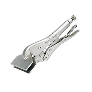

If you do use a valve use a ball valve--they are full flow. A gate valve is a restricting valve as sen in the pics. But you'll also need to have a reminder to open it. The hose is 12.5mm (call it 1/2"). So if you use a hose barb for 1/2' I.D. you'll have a slight restriction by about an 1/8", IIRC the I.D. of a 1/2" hose barb is roughly 3/8". Or you could switch to a 5/8 O.D. hose and use a -10AN fitting to retain the 1/2" I.D. but the threaded end of the fitting is huge. You can get ball valves with short handles and also in PVC, do brass or a stainless vavle. Or just go ultra low tech and use a vise grip, or something like the orange ones.
