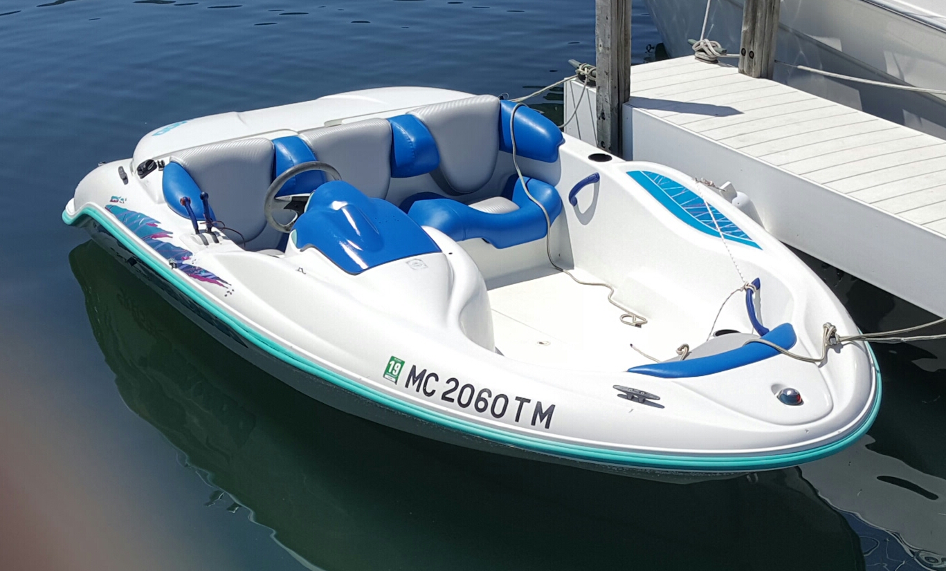

I got the ZZ auto group premade set 2-way stretch vinyl, they stitch the rear back rests and 2 middle bolsters, front back rest and front bottom (with mesh bottom and zipper like stock). The rear bottom had two seams, but it was a large rectangle so I assume you can make that work with one large piece. I used about 3,500 staples, removed maybe 1,000 new staples though just working and redoing spots.
Rub rail is going colorbond platinum silver, eventually graphics and turf I'd imagine. Throttles and handles colorbond blue, the handles were really gross on top of being teal.

OK, before and after shots. Being that I did the job my self completely with raw material (mostly no stitching) I don't think it came out that bad. I used carriage bolts for the seat cushions and that worked out pretty good. The only stitching I had done was for the inner arm rests. I pinned them and had a tailor do the stitching. I don't think they came out too bad, what do you think? 20170708_104417.jpg20170726_131424.jpg
OK, before and after shots. Being that I did the job my self completely with raw material (mostly no stitching) I don't think it came out that bad. I used carriage bolts for the seat cushions and that worked out pretty good. The only stitching I had done was for the inner arm rests. I pinned them and had a tailor do the stitching. I don't think they came out too bad, what do you think? View attachment 40900View attachment 40901
About 1,000 times better, the old seats belonged in a museum.
