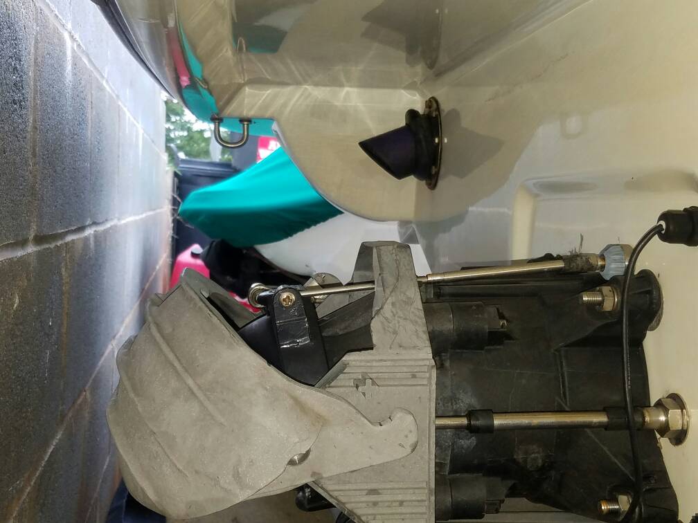

Are the ports in this spot on your boat?
Sorry for the bad pic,it's backed against the wall. Upper pic is a 96 speedster. Lower pic is 97 challenger. Or is the port like this one?lower pic
