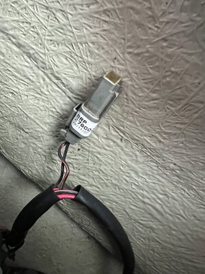

I have 2009 rxt-x power supply issues. Completely dead….I already replaced the starter solenoid, the starter relay and brand new battery.
After a day searching for my problem I found out that it’s a ground issue. When I connect or make contact for like 1 sec, between the black and black/purple wire from the Dess post to each other then I hear the relay click and the dash lights up and al systems and engine work. The lanyard key works as wel. When I take the key of the post and return again fast system stil works. But when I wait for about 30 sec, i hear relay click again and then system is dead again. The key will not return system on. Wil it be the dess post itself? Already spent 200,- for battery and starter relay.
Hope someone can figure out what I mean and offer some good advise.
