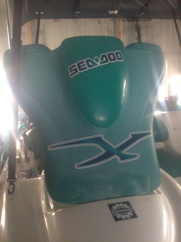

hi guys,
I would like to know if some of you have restored the plastic dash on a challenger 97 or other. On all the other challenger i've seen the color is faded. Someone has a trick or know a stuff to bring it back to look good!
Photo :
Thank you
