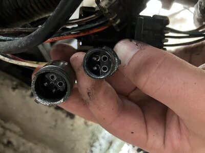

Check injector wire harness. Starboard, low. 3/4” dia. 4 wires. Pulls straight apart. Keyed for assembly.

Thanks Tim75 - yes, the connector looked decent with no corrosion. I’ve attached a picture and also some of a few loose wires - in the hope they might be the issue
