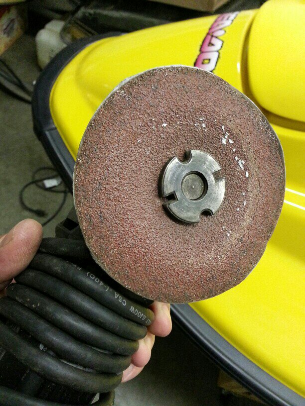

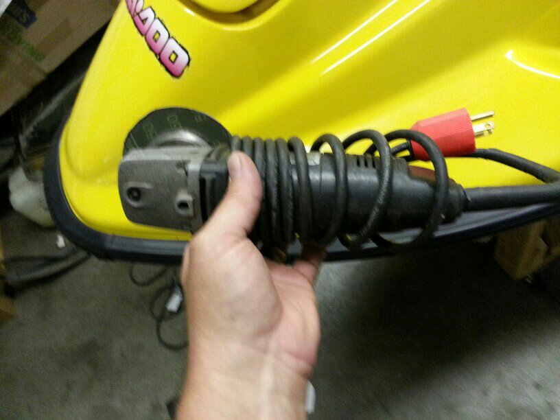

4" angle grinder with a 5" 50 grit disc. With the safety guard removed for maximum safety, watch your knuckles! Makes quick work of it.

I'd put that guard back on, friend of mine took the guard off his, disk flew apart and sliced the inside of his thigh good, cut a major vein. Cheap Chinese disk probably, aren't they all now?
