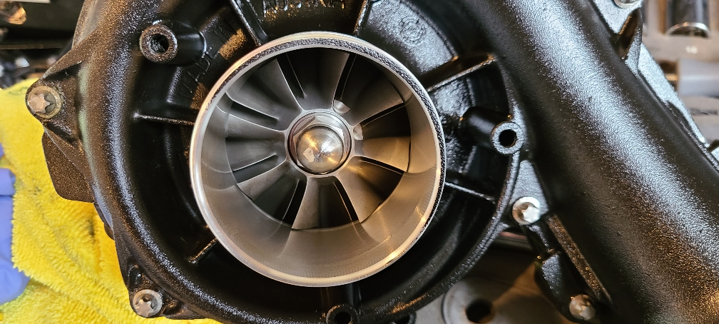

To confirm this, pull intake hose side of the SC and reach in and grab the compresser wheel by the nut and you most likely will be able to jiggle it around.

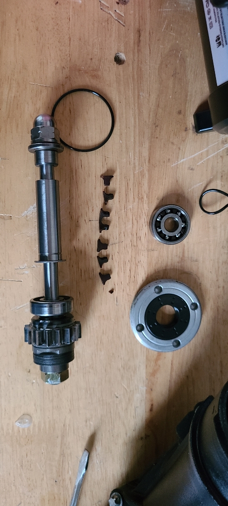

The SC has an outer and inner bearing and these bearings are in a plastic race. The plastic becomes brittle over time and breaks allowing the bearings to free float. This changes the bearing separation distances and allows the shaft to have lateral play. For me I was lucky because mine was the the bearing close to the input gear. This resulted for me in a large squeal like you mentioned.
I did not have touchdown of the compressor wheel but if it is the other bearing, you most likely will.
Again, do not run your machine.
I had all of the plastic still in the bearing so lucked out that nothing came out. I rebuilt the SC and was back in business.

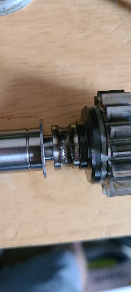

I lucked out, all of the plastic stayed inside. I also only had the squeal twice. The first time it happened right after a stutter incident. It worked fine after that but when I got back to the dock the SC obviously was louder. I checked the play and it felt maybe a little loose, which I chalked up to gear lash. The next day when I started it, I knew it sounded different but it worked fine, I went against one of my rules...if it sounds different, shut it down and figure it out. On a top speed blast squeal came hard with a loss of power. I shut it down and towed it back to the dock.
You can see on the raceway where it burned.
