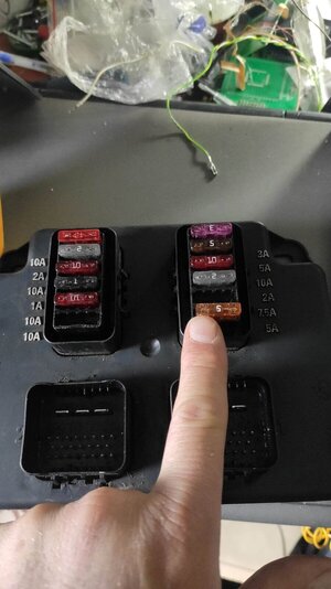

Iam new on forum. I found topic 2004 4Tec blowing 5 amp fuse and I have that same problem.
This 5A fuse is repsonsibility for EMS and starter stop starter. I make test on bench and seems MPEM is ok.
Anyone know and help me ?
What shuld I do
Thanks.

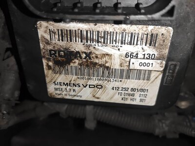

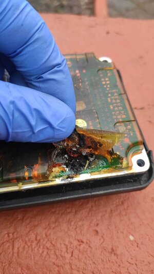

I found problem. I will try fix it but i think I should search second one ecu 412252001 - are is to replace?

That is why you don't jump start from a running vehicle. Your part number is incorrect. You need 420664133 which is the latest version but 130-132 will also work.
