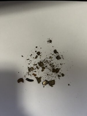

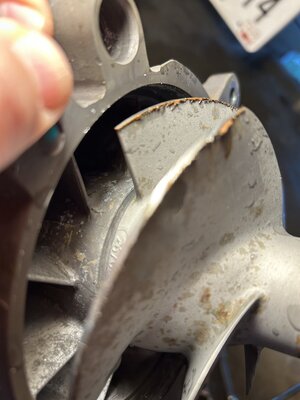

Pulled the pump and found the issue, pump bearing failure. See attached screen shots of NEW wear ring just replaced and impeller and metal shavings from the pump house.
After removing pump, the ski started just fine. The impeller was totally locked and wouldn't rotate! Hope no damage to engine!
