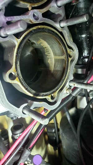

I'm glad I decided to run water through it one last time. After removing the head, I found that water was getting in below the head gasket (see pics). The builder used Permatex Indian Head Gasket Sealant between the gasket and head, but not between the gasket and cylinder housing, and it appears that's how it was getting in.
I'm trying to measure the pistons, etc. now. The builder doesn't think it needs a new top end since it only had 15 hours on it. I may just need a new seal kit to put it back together. I'm debating on whether or not to have a local shop deck the head and housing to ensure they're flat.

You can measure the cylinder diameters without removing the cylinder using the right tool. Then check the stamp on the pistons to see if they are standard or oversize. Ultimately you might have to remove the cylinder anyway, but that can give you an idea. Check your head with a straight edge to see if it's warped. After re-assembly, do a leak down test of the assembled engine to confirm it's air-tight. You will have to acquire or make block-off plates with gaskets to do the test.
