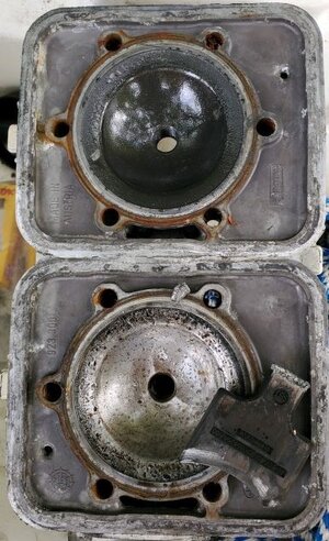

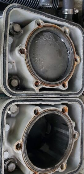

I've read that SBT rave valves don't need to be trimmed back at all unless your going over 1mm oversized. Is this true?
That won’t do anything to prevent the raves from hitting the piston rings. You have to remove material to make clearanceI just had my 787 rebuilt and I asked the mechanic about shaving back the rave valves as the cylinder was bored out 50 over and he said just add double gaskets and that will work. Ever heard of that? Well, I trusted him and took it out on the river and my rave valve cover melted and dropped my valve into the cylinder while running. Not sure why that happened.
Thank you. I appreciate the feedback and I should have listened to my gut and not a mechanic. He is saying now that the rave valve breaking up was not his fault and was not a mechanical issue, so it's not under his warranty.After thinking about what @DaddyLoafin said, I can't imagine SBT saying something like that. The height of the housing has no effect on the valve landing or distance to the piston. My GTX destroyed the threads on the rave pistons on 2 valves in succession and only on the mag cylinder. You don't get much help a all with problems like this, you generally have to solve them yourself. I called an engine builder that had no clue.
I had called them and the guy I talked to told me that they were made for stock bore and had to be shaved.After thinking about what @DaddyLoafin said, I can't imagine SBT saying something like that. The height of the housing has no effect on the valve landing or distance to the piston. My GTX destroyed the threads on the rave pistons on 2 valves in succession and only on the mag cylinder. You don't get much help an all with problems like this, you generally have to solve them yourself. I called an engine builder that had no clue.
I have never bought an engine from SBT but I thought if they sent you and engine the raves were sized to fit. I took a couple of SBT engines apart, one failed before 5 hours run time. I thought people were biased against SBT but after I saw the kind of work they do I'd never put one of their engines in anything. Sad but that's my experience and it is OK to disagree.I had called them and the guy I talked to told me that they were made for stock bore and had to be shaved.
I remember reading online somewhere where someone said that they were made for whatever bore sbt uses but that is not true.
