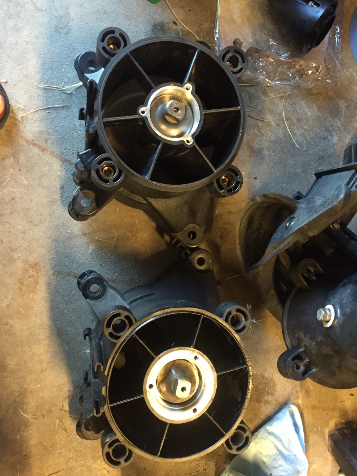

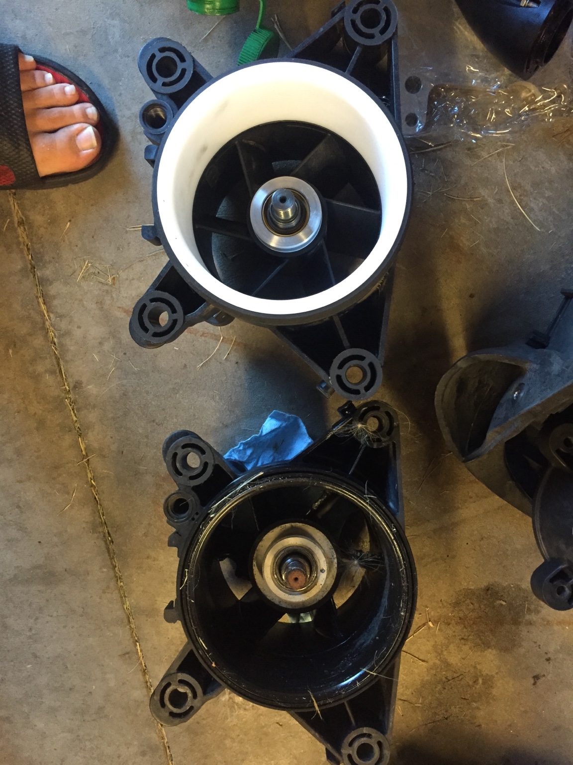

I purchased a jet pump housing for a 98 speedster. It seems like they sent me the wrong one. Take a look at the picture and tell me what you think. Look at the diameter where the bearings and shaft are mounted
I'm in the exact same boat, no pun intended. I've sent and email out the place I bought the jet pump housing from to see if its as simple as putting new cones on it. As far as I can tell that would solve our problem.
In 98 the Speedster got the new Large hub pump and in 99 the other boats got it IIRC and so did the RFI powered skis. The older pumps have a much smaller hub. While the smaller will work, you should really use a small hub impeller. You shouldn't mix and match between the 2 pumps. 99% of places have no idea of this switch in 98, the dealer would, but the aftermarket doesn't really. Which is obvious, you got the wrong pump housing.

SBT needs to make good on their end. There is a reason Seadoo switched to the big hub pumps on the boats in 98. They need the better bottom end with that pump. You potentially could have cavitation issues with the smaller hub pump. I would not compromise on the pump no if ands or buts about it. If it means you miss out you miss out.
SBT sent me a new housing. It's actually the same small housing I received in the first place but it came with the correct anti rattle nose cone.
