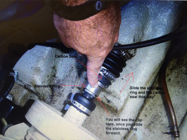

Max run time on the hose really does not need to exceed 1 minute or so. Are you familiar with the Carbon Seal (CS) and how it works?

The CS is basically the seal from the hull to the water you are riding on. It is a non-greased item. It gets its cooling and lubrication from the water you are sitting on. So, when out riding, water is up against the CS. It is designed to leak at part of its cooling and lubrication. That said, the leak is to be a DRIP, not a stream.
So, when you run on the hose, the CS gets no cooling or lubrication and will wear at a much faster rate as compared to being in the water. The CS gets hot quickly out of the water anytime the engine is running. Thus,,,1 minute-ish is all you really need to run on a hose as beyond that it does not serve much purpose and in fact can harm the CS.
Wow, I did not know that, thanks very much!

Max run time on the hose really does not need to exceed 1 minute or so...
30 seconds to 1 minute is the max without water at idle. 5 minutes is the max on the hose. It takes a while for the carbon ring to overheat.
