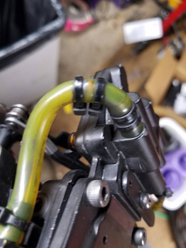

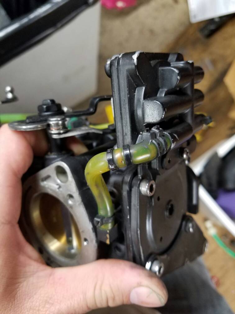

This is the jet that gets lost
Yes 1of500. He threw it away. But he also has the wrong needle arm springs.
Multiple issues.

Honestly the accelerator hoses never go bad so nobody should be replacing them.
I appreciate the responses guys. I'm going to call the Sea Doo dealer when they open this morning and hope that they have the springs and needle and seat. If not I guess I'll be ordering them. As far as the jet in the accelerator pump line: I've read multiple threads of people removing them or others that simply don't have them. Is this something that I really need to replace? I wouldn't even bother to ask but my accelerator pump nozzles are squirting fuel like they should.
Good luck with the dealer, most don't stock any of the 2 stroke stuff anymore.
Yes, you need that jet as it limits the fuel going into the pump, seadoo put it there for a reason.
