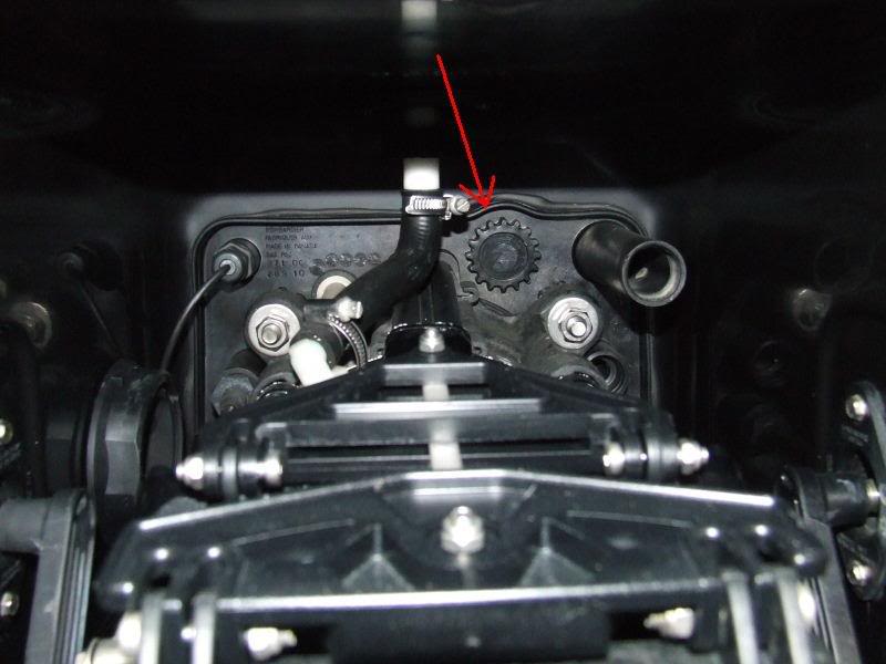

I thought there was a place in the back to hook up a water hose, seemed like they had a female fitting built in, was I dreaming this???

Yes, it is pointing out the back by the jet pump assy nozzle. You can get a fitting at a seadoo dealer(cheaper at Walmarts) to do a quick connection, or screw the hose in the fitting.

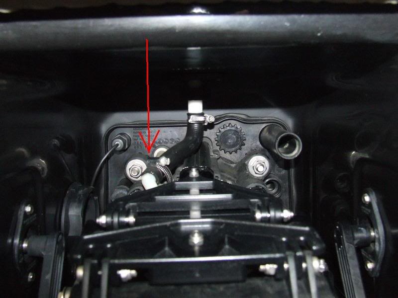

Are you talking about here???
The fitting on the right in the picture. It looks like a tube.It should have threads in it for a garden hose. The fitting should screw into the threads in the pipe.

I'll be dam, I always thought that had to do with the exhaust, I just got back from hooking the hose up to it!!! THANKS...:hurray:
If you go to walmarts, you can get a fitting that is like a quick-connect... to connect to the hose and it screws in the connection on the back of the seadoo. than you don't have to keep screwing in the hose...just a quick connect. Cost like $2.00
