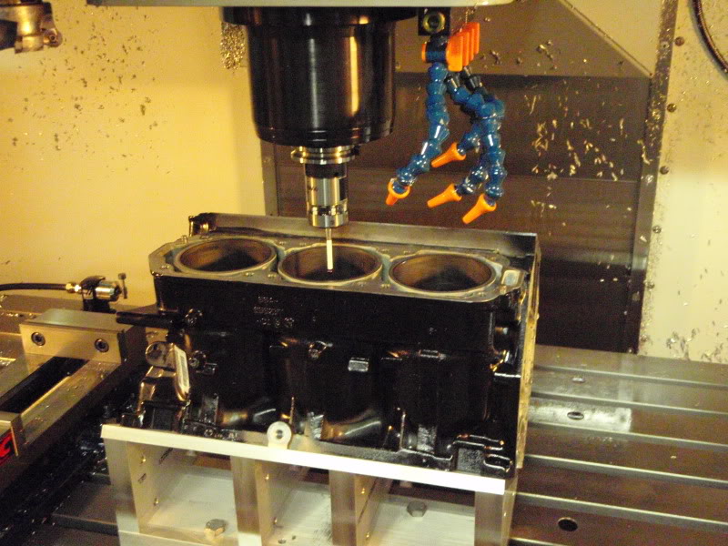

Sure... if you found a machine shop that has good CNC machines... they could write the program to cut it open. Then you can just get the OEM parts, and tap into your water warning box. (I think the wire is already there for the sensor)
I use to cut Suzuki heads to add decompression fittings. It's the same process. (but unfortunately, I closed my shop last year)

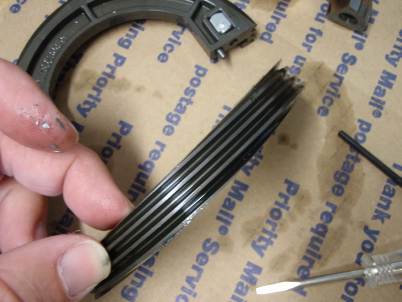

Yes there is... but I'm not sure if it would be noticeable in the block... on a warn gear.
The top picture is the gear out of my "Blown" engine. You can see that the surface is smooth. (typical plastic) BUT... you can also see that the gear was in perfect shape. Yes, it's a known wear item that can fail... but it only fails when you have overheated the engine a few times. Basically, when you overheat the engine, the bushing that the pump drive shaft rides in, gets tight. When it gets tight, it puts pressure on the plastic gear. In turn, it takes the teeth off.
The lower pic is the new gear. You can see that it's now a fiber filled resin.
Thank you for the pics! You said the difference between the new and old gear may not be noticeable if the gear is worn? Is that correct? If it's not worn, will I be able to notice?
I don't know. In the engine... it's mounted into the crankshaft, and all you can see is the "Teeth". (if you are looing in with a bore scope) Since I haven't inspected my own engine that way... I don't know what you will see. But I suspect that even the new gear... with a little time, and coated in oil... the teeth will polish, and look smooth. (but I don't know)
