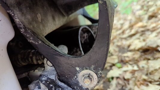

I have Seadoo sportster 4-tec 2003. The reverse gate covers part of the steering nozzle when the gate is in forward. If I push the gate with my hand it does pop up and clear the Jet. This is on dry land. I am wondering if this is normal and the force of the jet will push the gate up or if it is blocking part of the jet while the boat is running?
My max speed is around 38mph. It should be closer to 50mph. Perhaps this is the issue?
I have attached some pictures. The gates looks to be in the proper position for reverse. Would appreciate any thoughts on this issue. Thanks,
-Tim

Hey Tim. If no one answers in the next 3 weeks I’ll try and remember to look at mine. It’s out of the water so I can look but not for a few weeks.
you might be right though. It doesn’t look correct at a glance. the gate should not obstruct the jet. And I would suspect reverse is controlled by a tab or something. As in regardless if forward is misaligned the gate can only drop so far.
when your in neutral does the boat creep forward or backwards at all? My neutral is slight forward movement (not that that’s ideal/correct). Could be an indication if yours is moving backwards.
There should be a cable or rod to adjust. You remove a nut then the rod comes off the gate, then you should be able to screw the rod in or out to adjust gate position. In your case you’d be moving it in. See this vid at about 1:23
Vortex pump and gate
Tim not running and out of the water, using the shifter at the controls, push it all the way forward. It should go all the way to up to clear the nozzle of the jet pump, completely. In neutral, the bucket should be almost covering the nozzle of the pump, about 1/2 way into reverse. The boat will still creep forward in this position. Use the shifter to shift from forward to neutral and then reverse and look to see the correct position of the nozzle pump. you can make fine adjustments of the cable on the left side of the pump or at the controls if need be, by pulling the controls out and adjusting the drive cable there. I hope this helps. Karl

The gate definately needs to be adjusted and I will do so when it is out of the water. Thanks for the video.

Just as a quick update, I did adjust the gate and clean the injectors as well as replace the fuel filters.. The boat is running much better.
Note that you really need to bend the cable and sleeve up to get enough of a gap to turn the square nut.
