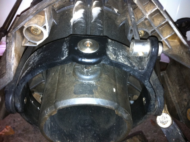

I'll have to check the parts diagram... but none of seadoo's pumps just have pivots. They should be bolts, with a "Head" on it, so the parts are captured.
Can you post a pic of your reverse bucket pivot?

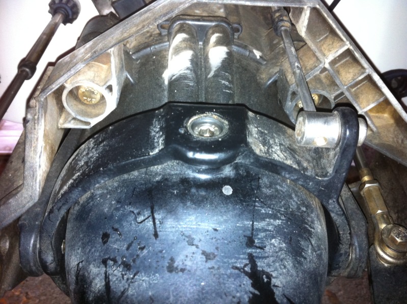

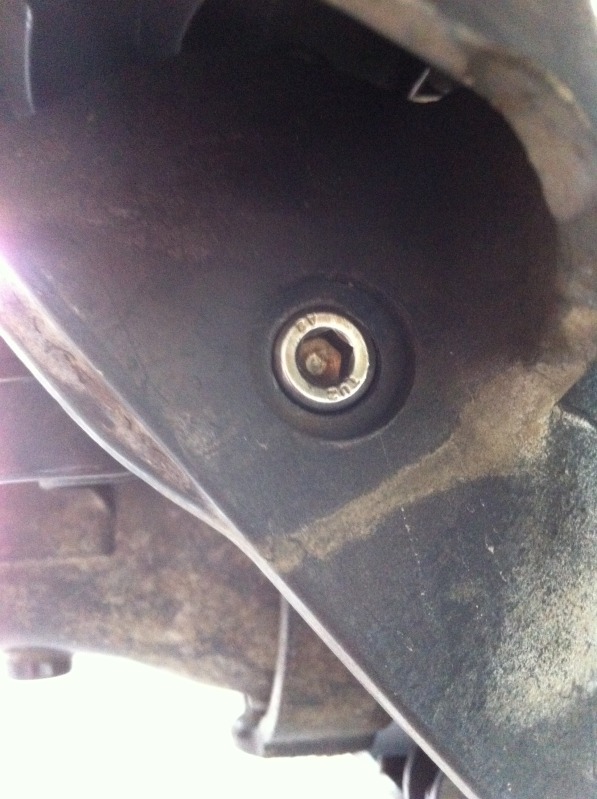

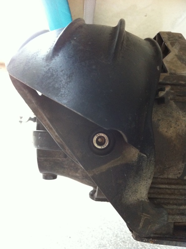

The bolts didn't come off, the bucket simply popped over the bolts. Looking at it now I'm thinking the bucket/gate has the wrong bolts in it...
Now that I've looked closely at things and the recess in the gate pivot I tend to agree with you guys. Now I'm left wondering "who the hell replaces bolts with the wrong ones"? I hope they're not putting wheels on cars somewhere...

Those are the wrong bolts.
Chester

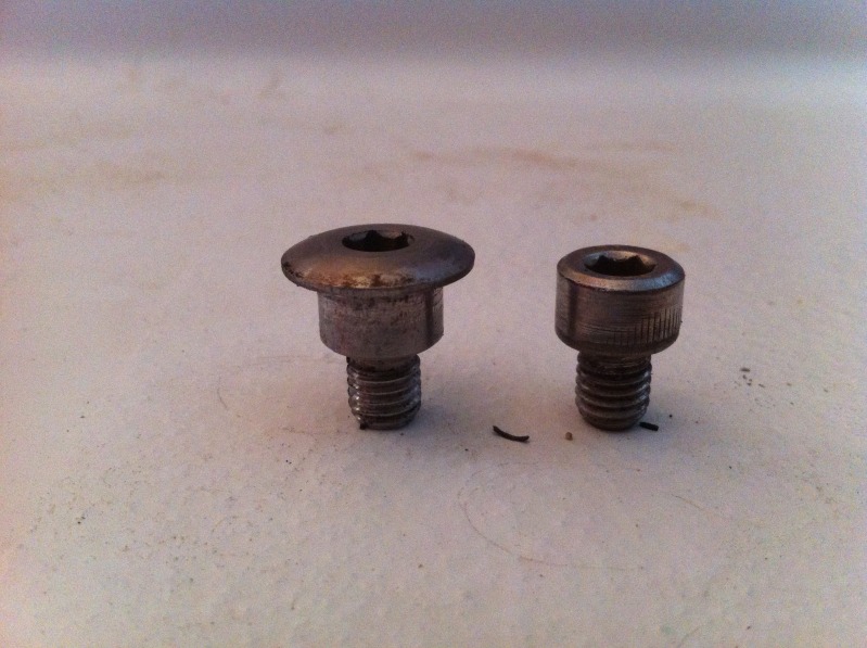

Agreed. There should be a washer/bolt head in the recessed area of the bucket. From the looks of things all those bolt heads are doing is filling the hole, not actually holding anything on
Well, problem solved. It would appear that the correct bolts were in the steering nozzle and not in the reverse gate. Now, I had the whole pump apart over the last winter so I suppose it's possible I'm to blame for the mix up. But, I'm pretty sure I put everything back the same way it came apart. Learned a valuable lesson though - just because that's the way it came apart doesn't mean that's the way it's supposed to go back together...
