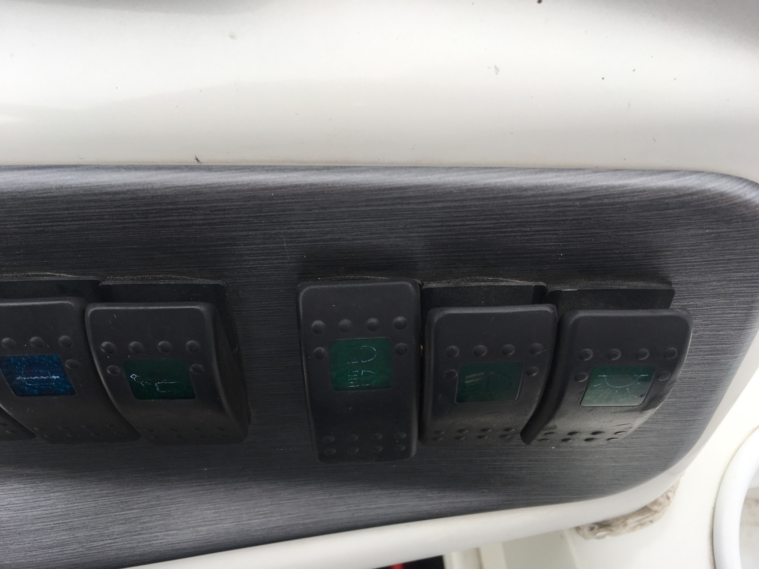

My docking light switch is broken (in the ON position) on my 2001 Islandia. I ordered a replacement piece, has anyone ever replaced one of these switches? I have no clue... I attached a picture! Thanks guys! Really appreciate it
Mike
It's easy. They are basically just "Snapped" into place. So.. get behind the helm... pull the wires (plug) off the back... and then squeeze the tabs on the side of the switch, and push it out. Don't even need any tools.

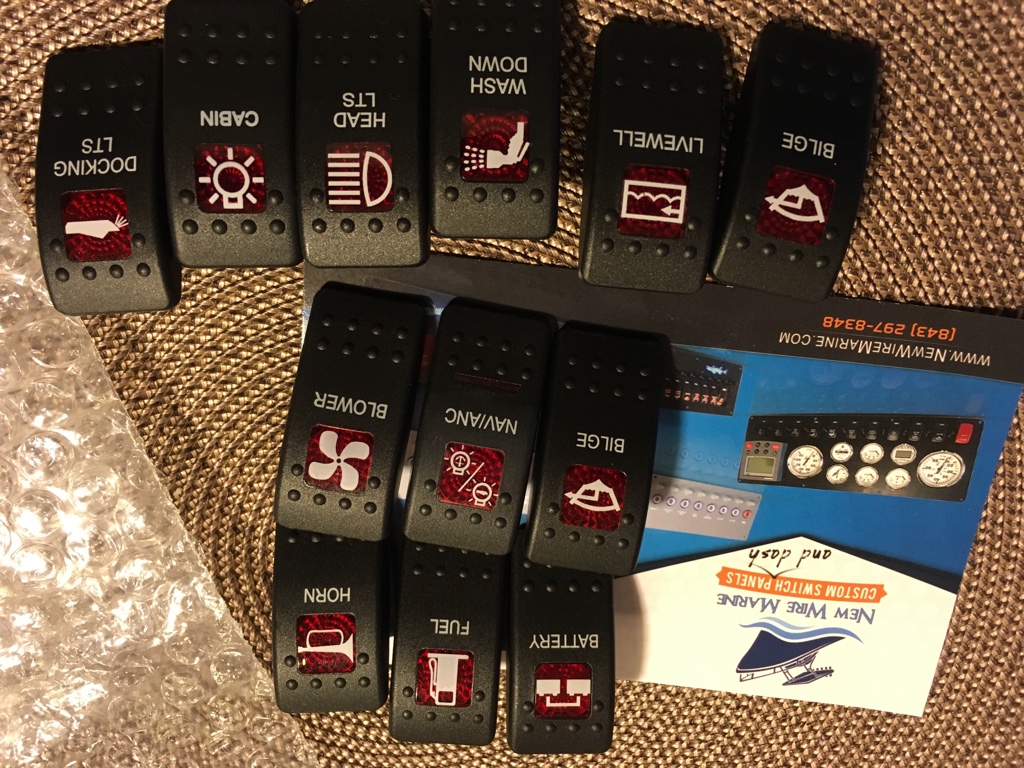

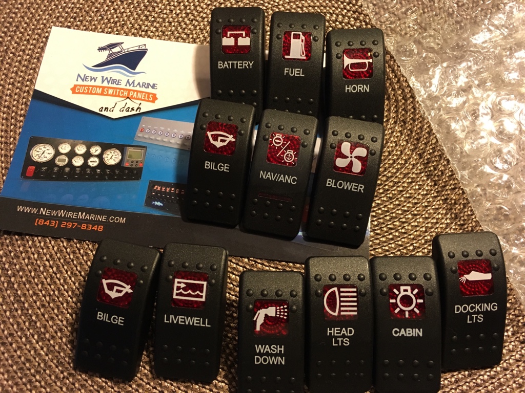

These came in today. Not exactly like original but will do the job.

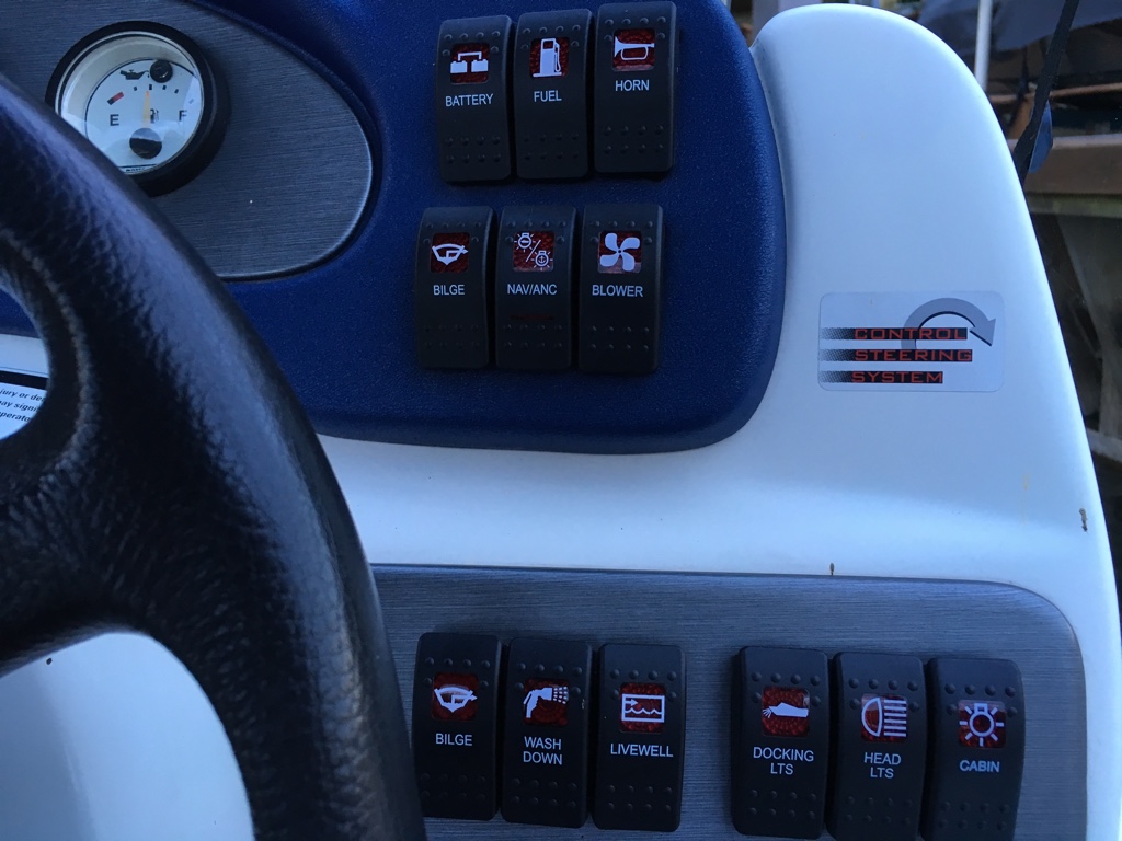

I chose red because my radio display illuminates red lights.
Got the from New Wire Marine in Charleston SC.
Will post another pic when installed.
