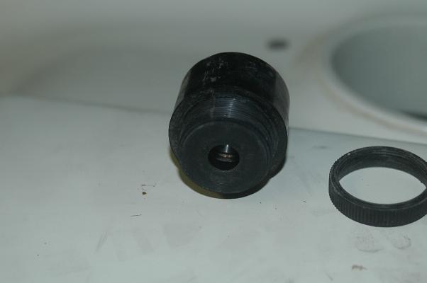

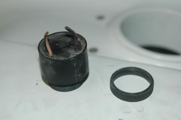

Second step: unscrew the old buzzer and cut the wires at the buzzer:

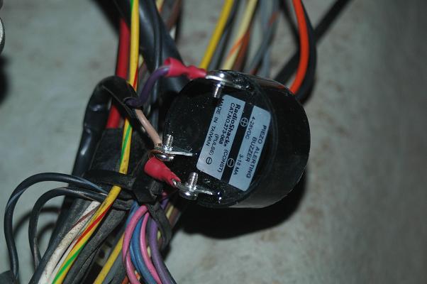

Third step: strip back and attach the wires from the old buzzer to the new one.
With the above radio shack part, the purple wire goes to the (+) side, and the tan wire goes to BOTH terminals on the (-) side.

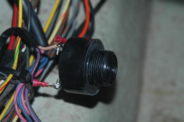

Fourth step: push it back into the factory hole and thread on the mounting ring from below. I needed to sand down a bit of the mounting ring to get it to stay put.
