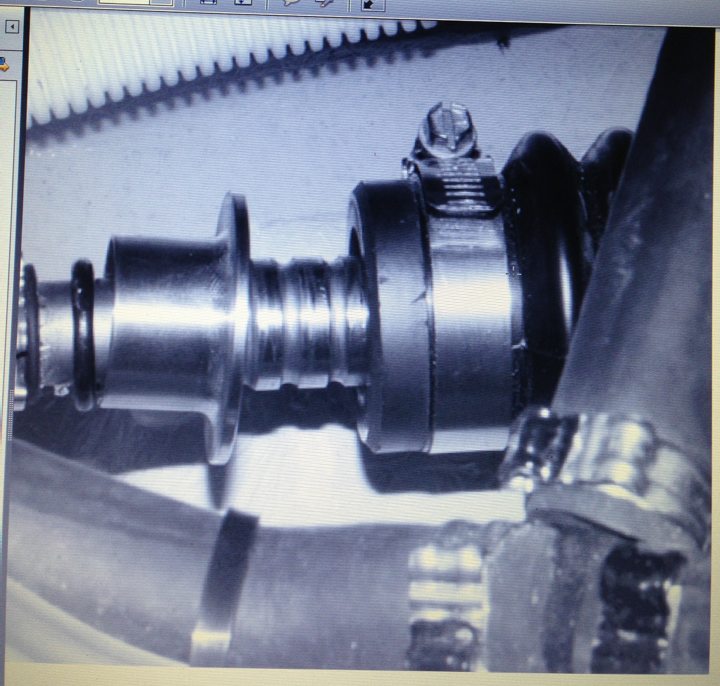

Here is a picture right out of the manual.
It looks like three potential adjustments to me.

Update!! My boat- all good and showing no cavitation like last time. Yes, i pushed the stainless ring and all good! Just took a video of it while my wife driving... Sounds good? :cheers:
