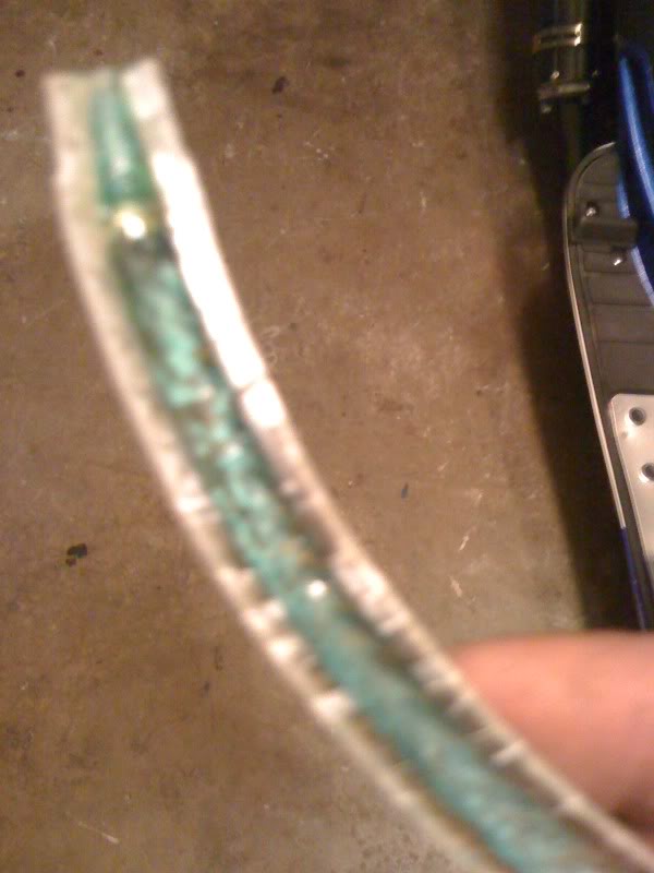

So today i finally got off my lazy bum and got to replacing the gray fuel lines on my 2001 seadoo gts. Overall it was very simple and straight forward (im used to working in tight and nasty places being as I am a mechanic).
I would have a severe loss of power at full throttle. I would clean the carb and it would run great for about an hour, then go right back to having a power cut. After reading on this forum i decided to just replace all of the gray fuel lines. Found out they were pretty nasty on the inside (never been changed). Im going to clean the carbs again and see if the problem is fixed. I dont think the carbs need a rebuild, since they work great after being cleaned. Oh well, here are some pics of the disgusting lines.

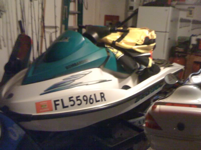

And my ski

There are little filters in carbs that get filled with that green crap!!! When I took mine off they were jammed packed with the stuff.. I aslo had to get rid of my fuel selector switch, that was all gunked up too...
While you have the carbs off to clean the internal filters out, remove the LSA and HSA to clean them out and blow out the jets. If the diaphragms look bad you might want to just do a rebuild on the carbs which is pretty easy

At the least I would check your internal filters in the carbs. Mine were completely clogged up even though the fuel filter was perfect. These tiny filters get clogged very easily especially from the gray fuel gunk.
