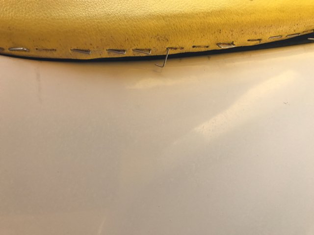

I need to remove the drivers arm rest on my 99 speedster to fix a few staples that have come loose. I can tell the plastic under the rest has a few cracks so I need to be careful.
How do you remove the drivers arm rest and any trick to reinstalling?

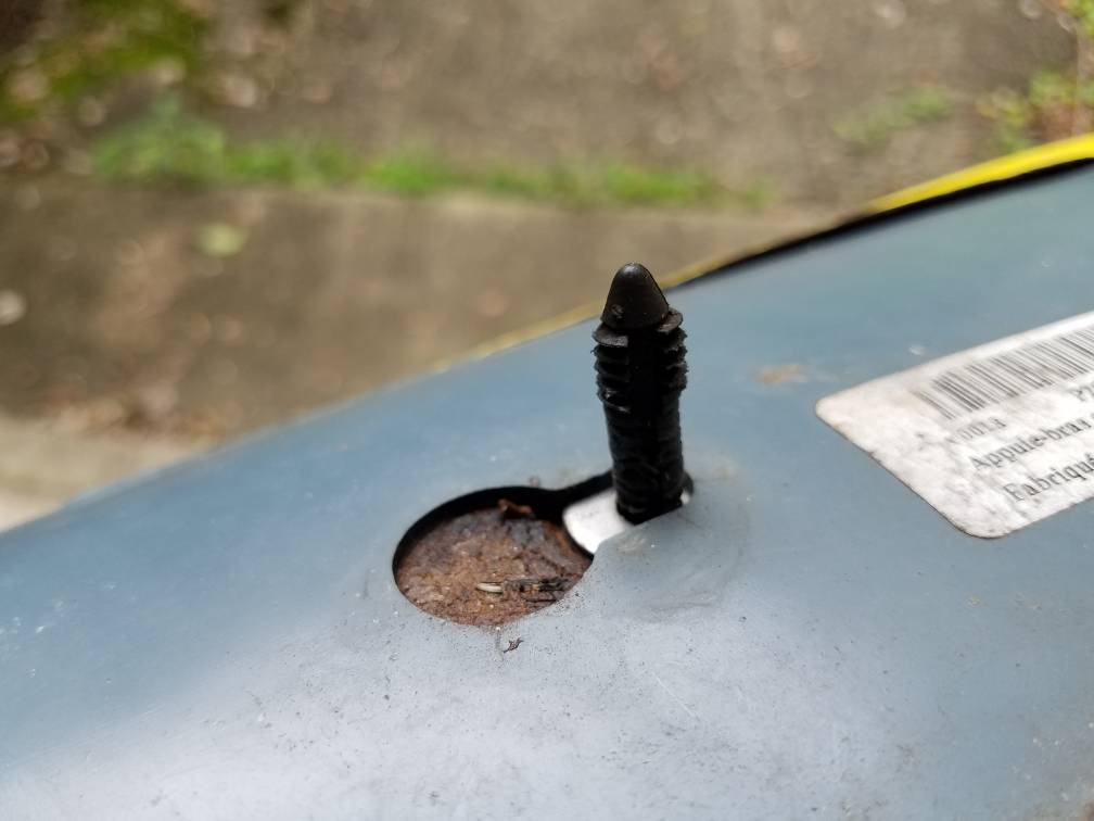

It's just pushed on. There are those black plastic Christmas trees with a washer under the head that would be on a card for panel back in the day. You need to be extremely careful. The gray plastic is kind cheap. The staples are so close together the actually we're probably all cracked from the factory. You will have no extra material to work with since they cut the excess of linearly right behind the staples. So if it's just lifting I wouldn't touch it. If you want to wait a few days I can take a pic of mine so you can see what I'm talking about.

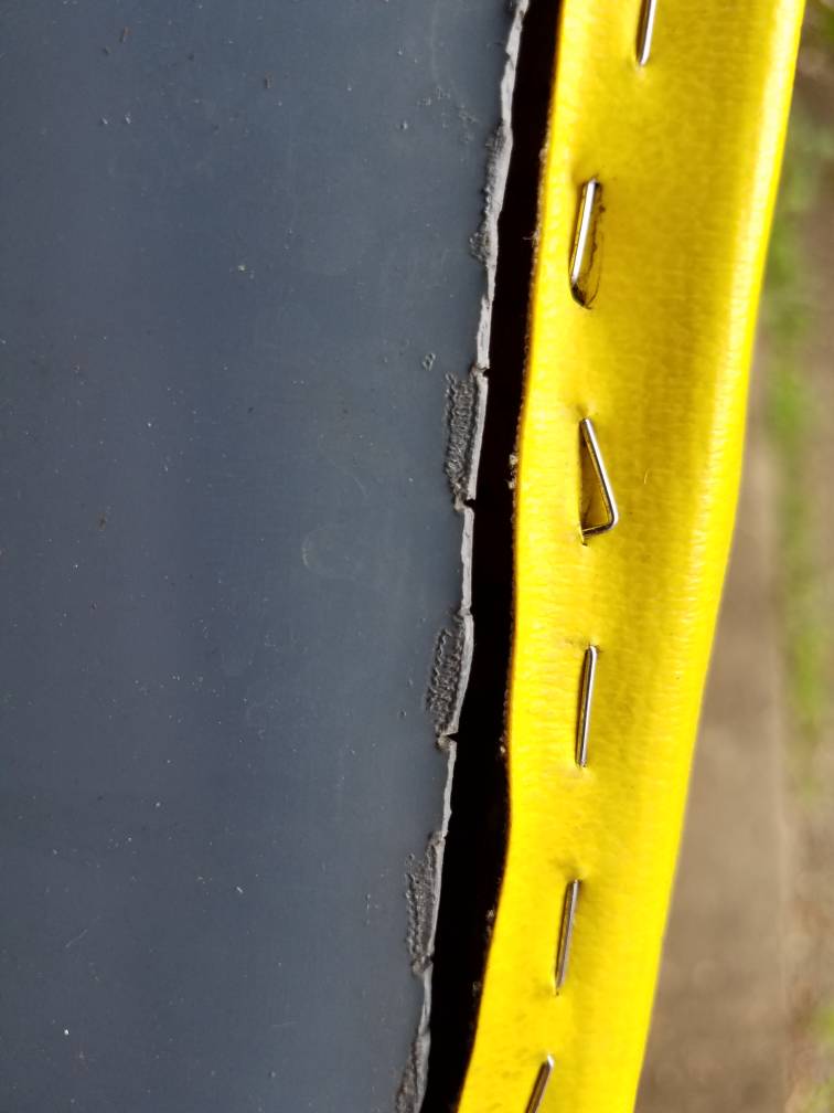

Sorry for the delay
You can see they split right at the staples.
Awesome info and pictures.

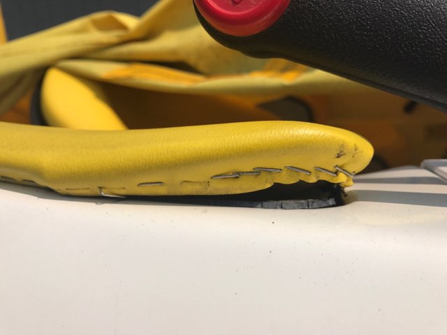

It happened!!! One of the kids used the already fractured arm rest to pull the boat and made it a lot worst. POP!!! Armrest is almost ripped all the way off.
When reinstalling the arm rest sits funny with all the breaks in the plastic. And has even more staples sticking out.

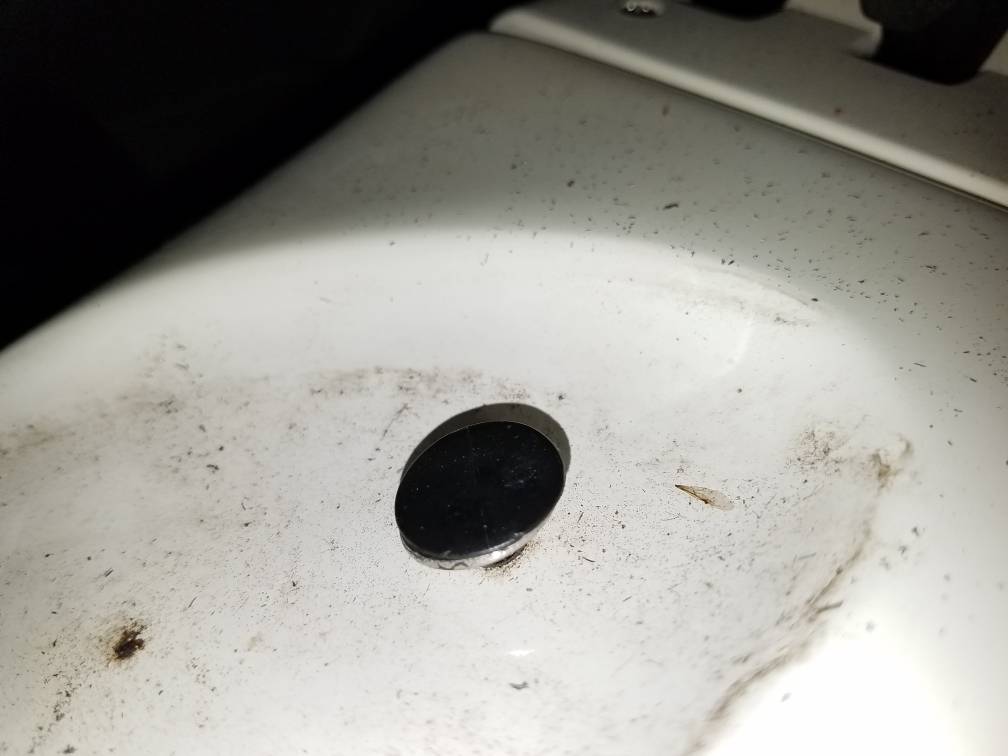

I will need to drill a 4th hole for the extra pin BUT i am excited that it has an extra support pin.

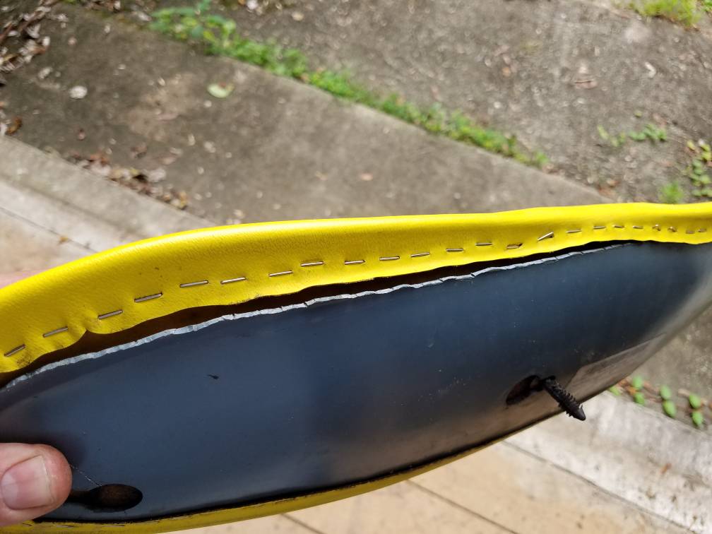

Interested to see if it's right. It looks like it has a piece by the 4 that's bent 90°. Although from the top it looks similar. One of these days I might make one from fiber glass.
It looks like that might be an optical illusion from the camera angle.
Here’s mine “that I zip tied to the best of my ability to match the picture” and it does the same thing as in the picture.

It Worked!!! New Arm rest installed. “Had to drill one hole.”
***Rest is the same size! Sorry if the pictures make the new look bigger(camera angle)
