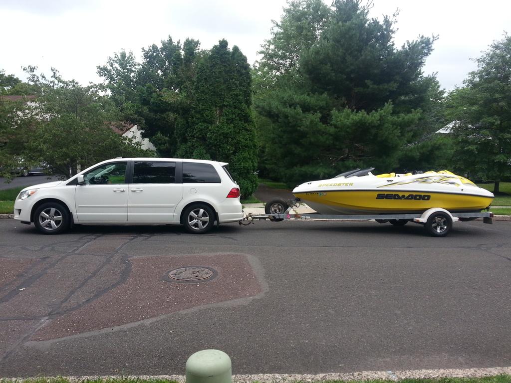

Not knowing what year your van is, we tow with our 2010 Routan on long trips to keep the family "comfortable". I did buy it with the tow package which was the 4 liter engine, HD cooling and nivomat rear shocks to keep the ass end level when loaded. As far as frame strength and brakes, they're the same. Only diff is the cooling system and rear suspension. Again, not knowing what year your van is doesn't help. That being said, by specs your van is under by manufacturers specifications. You get into an accident and the authorities investigate it might not look to good. My Speedster is probably 200# lighter than what you're inquiring about. Your best bet would be to NOT tow with that vehicle.
Yes the ass is squatted in this pic, it takes a few miles for the Nivomats to fill and raise the height. The over night they will bleed back.
