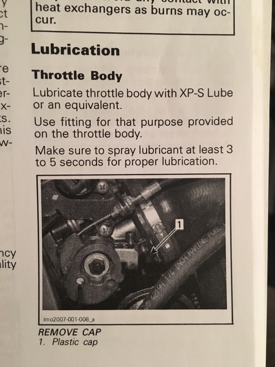

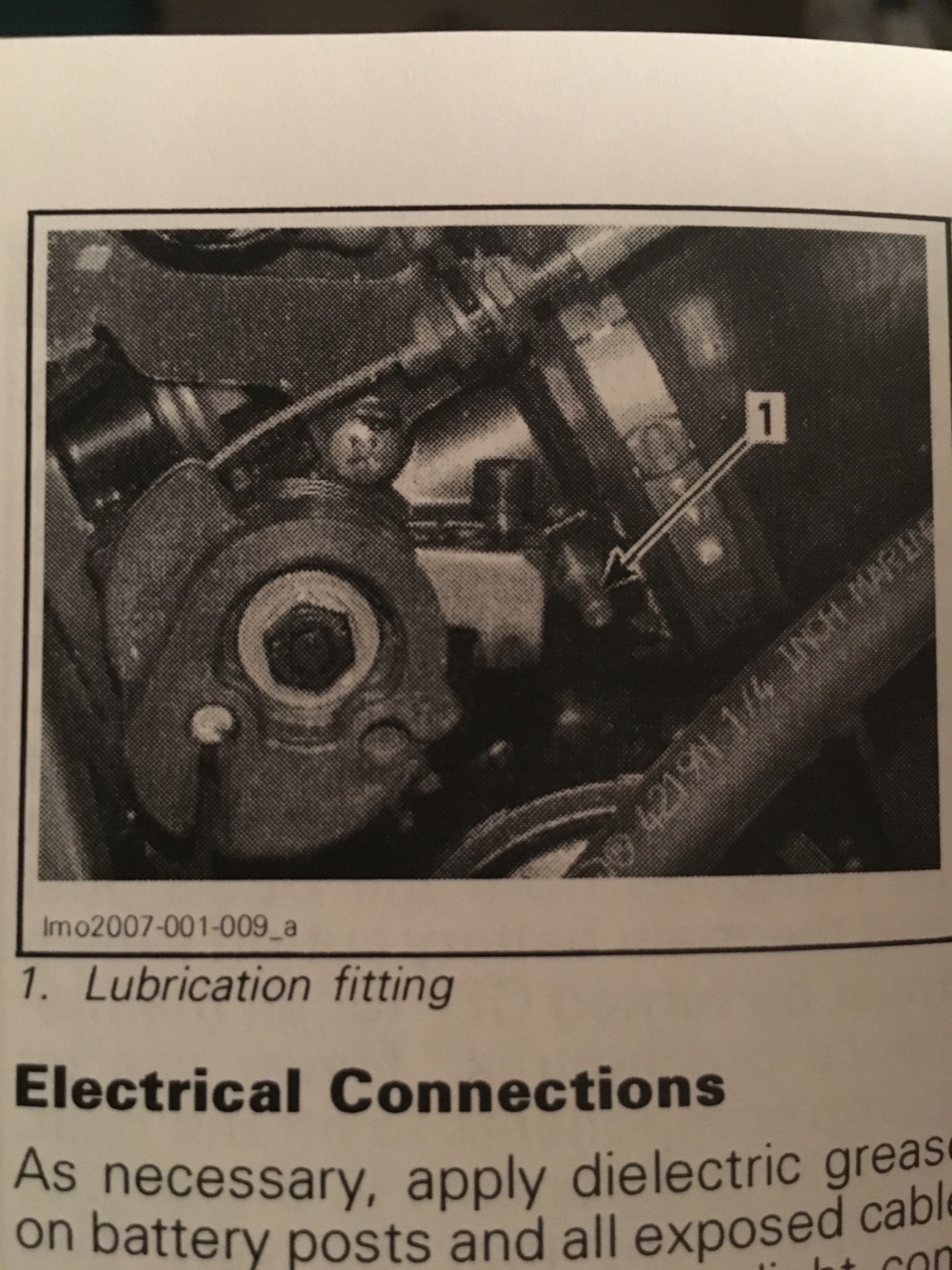

OK. After running my boat for the first time I noted a little oiliness on top of the filter housing. Maybe it's an oversight by me but as I was researching I noted there is a brass nipple on the throttle body point right at the filter housing. Did I forget to put something back on here or does that nipple vent to atmosphere or nowhere? Ran perfect.
Here's a generic photo I found on the internets...looks like the right TB and the nipple highlighted...
