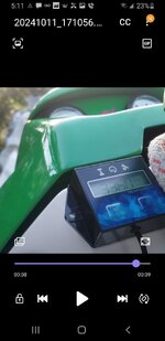

Running at idle, 13.6 v. So I think the charging system is good. But I doubt the rpm is accurate. I'm using one of these tiny tach that you wrap the wire around the spark plug lead and set it to 2 stroke 2 cylinders. And it says I was idling at 3300 rpm. I wasn't even touching the throttle.
What should my idle rpm be?
Answering my own question, service manual says 3k when out of water.
So am I supposed to dial it down, never done it before, anything to watch out for?
No, just turn the idle screw an 1/8 of a turn. Can’t remember if it’s in or out though. Either way you will know
