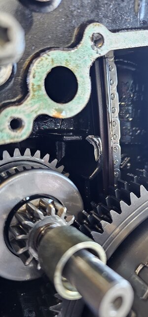

So I think I found the source of those shavings... looking in the supercharger hole there's a part of the case worn away (attached).
I cant figure out what would have hit it though.
This engine has been opened before, oil pumps were rebuilt, I haven't taken the bottom off yet. Everything's been clean, nothing im the screens, so I'm contemplating if I even should.

So after holding up the supercharger to figure out what might have done this, the gouge by the starter bendix lines up with the SC washers or the nut. Either way, I don't know enough to estimate how that could have impacted the case. I couldn't find any other damage aside from it looks like the stator coil rubbed the metal cup at some point.
I'm thinking that this mark was pre existing to me finding metal shavings in the filter.

That damage is typical of sc failure where the sc gear breaks and/or sc bearing failure. My guess would be that the sc failed and they did take the pto housing off and cleaned it out. If you don't find any evidence of broken ceramic washers or damage created from those, that is a good thing and most likely the engine will be fine.
That's what I was kind of piecing together.
Oil pumps have been rebuilt, pto housing gasket was aftermarket, everything is generally clean.
The only thing I haven't pieced together is where the metal shavings in the filter came from. Unless of course it's really typical as suggested. Generally feeling better about the whole thing.
Thanks
