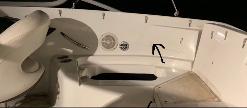

Hey. Removing the seats is easy. Run your hand along the bottom of the backrest until you feel a little gap in the backer. This is where a single Philips screw is placed (about where the arrow is in the picture). Compress the cushion upward to see/remove the screw. After that, you just push upward on the seat back and it will slide off of the hangars you see in the picture. Same method for the front. The bow cushion has two screws (if memory serves). Seat bottoms are all hinges or bolts. The bow seat back hinges are riveted in, and have to be drilled out. The rest are super easy.
Thank you very much for that walk through!
