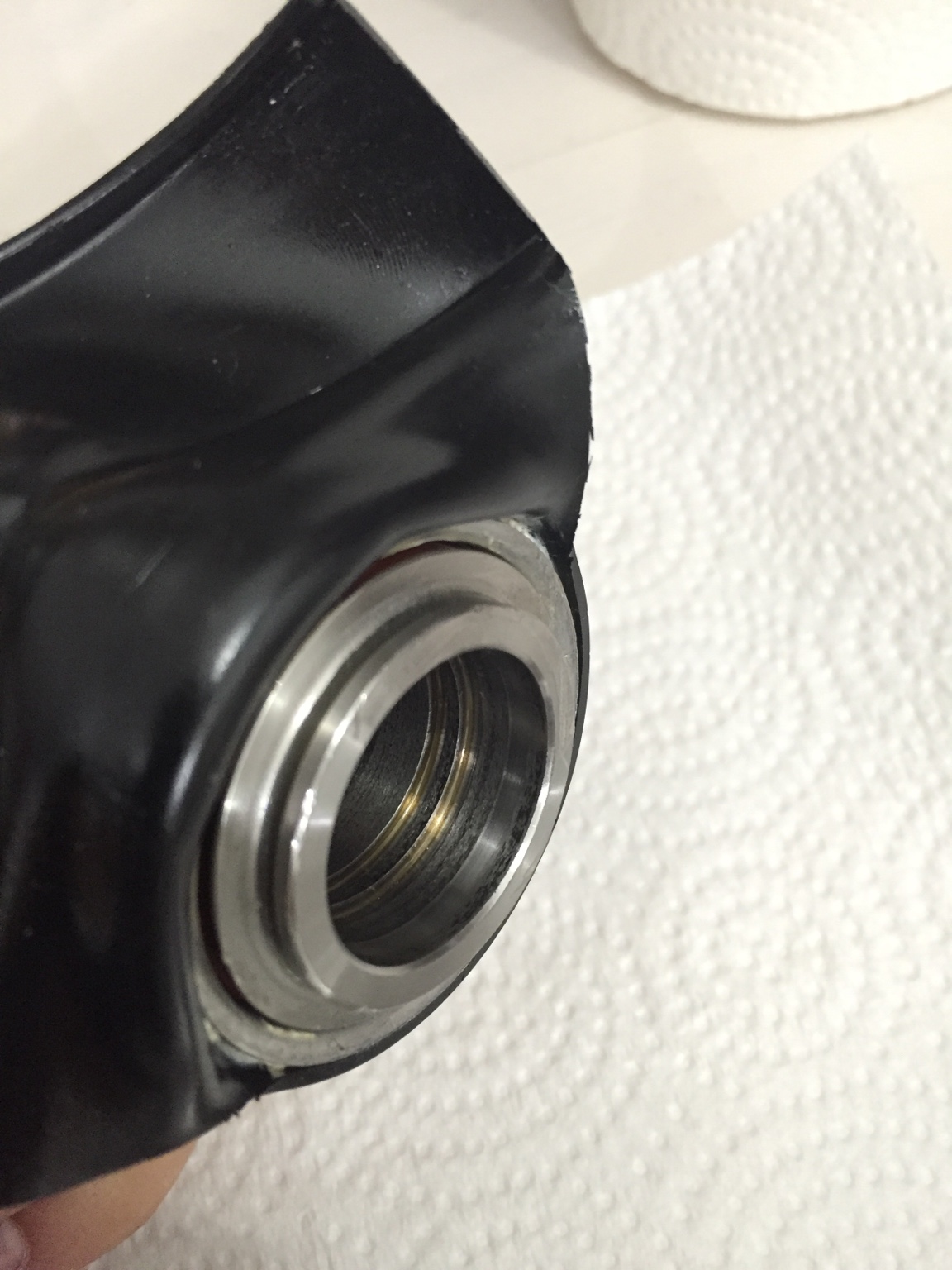

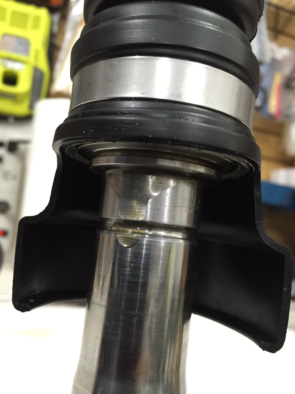

This is what I found, first the drive shaft where the PTO bearing sits is pitted? the inner collar of the PTO bearing looked rough... the o-rings were in place but I could slide them side to side in channel they sit in?
I also found some rubber bits up by the bump stop at the end of the shaft. My thought was the pitting was wearing down the o-rings and that the o-ring might not be the proper ones in the PTO housing.
What is the actual bearing like? Are you able to rotate it or has it seized? The rubber o rings should be a nice tight fit both in their grooves and around the shaft.
The bearing looks and feels ok the collar with the o rings defiantly does not have a snug fit on the shaft like the bellows for the carbon ring. I think they put in the wrong o rings and the shaft is not smooth in that section. I'm wondering if the old bearing was seized on causing the pitting and the dealer put a new bearing on the old shaft.

Damn... That is a very loose fit! I would smooth the shaft with some wet & dry sandpaper to make sure the seal is good when you put in the new rings. Also make sure you check the alignment when you reinstall.

Thank yep I'm going to install new o rings and either get a new shaft or have the old one repaired to make sure the surface the o rings ride in is smooth and not pitted like my first photo. Oh and I'm checking the alignment too.
I don't think you need a new shaft, that one looks pretty clean and I could not see any wear on the splines from the photo, I've seen some really rusty ones reused by people on this site and others without any issues. I'm sure you have the skills to clean it up..... That said, sometimes I just replace parts with new ones for peace of mind even if the old part is still ok :)
IMO you're driveshaft is fine. The orings spin in the bearing with the shaft. Smooth it out a but with some 2000 grit sandpaper so the shaft will slide in a bit easier.
You can always replace orings then slide the bearing over the shaft and fill it with oil again to check for leaks. (excellent idea on your part BTW)
Well I picked up the new PTO bearing assembly with new o rings on the old shaft it was better but when I tried it on the new shaft in the store there was a noticeable difference! I had to work it on with a little oil on the rings a much better seal and feel so I went with both parts new..... I was amazed how much difference there was with the new parts.
