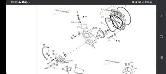

So, I have a 2 stoke oil leak I'm struggling to locate. Here's the whole story: My 99 GTI engine went kaboom so I went searching for another 717 engine for it. I found a 2000 GS that was sitting for a while with no history behind it. The hull was full of oil but the compression was at 140 and the engine looked mint, so I bought it. I did the swap and now my GTI hull is getting 2T oil leaking in it. I traced the leak all the way back to the oil injection / rotary valve cover area. I thought it was the oil injection so I swapped it with my kaboom engine's oil injection and that didn't fix the issue. So what would be your next move? By a Rotary valve cover seal it or would you look at something else. Like I said it has nothing to do with the oil injection or the lines since those were already there attached to my kaboom engine and I never had that issue.
