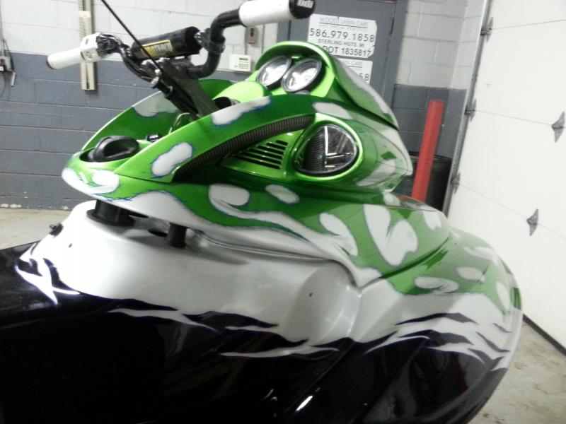

Don't give up, that is a killer paint job dude. Did you do it yourself? You are on the final stretch of the build and you have THE BEST seadoo forum at your disposal. We can walk you through it

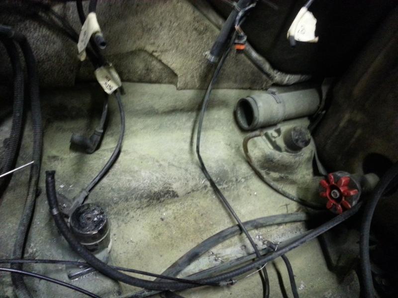

Send me a couple pictures of the inside of the hull. So I can see what is left to do. I will have some time off work soon and might be able to help. Did the guy align the motor? Are the carbs on? Were the fuel lines replaced? Did he rebuild the carbs too? Did he do a full rebuild? Or just a too end? You pmed me a few times but i work afternoon shift so I just got home. Do you have all the parts? Here is the issue, someone else started a project and never finished, so parts could be missing, something could have been installed wrong, who knows if they used the correct torque specs, sealants, gaskets, locktite. A big thing is that all parts and HARDWARE are there. If all he did was set the motor in, then there is alot left. The motor will have to be aligned, driveshafts installed, pump and hull probably need silicone scraped, reapplied and pump installed, exhaust hooked up, fuel lines changed/hooked up. Oil lines hooked up. Oil pump aligned, cooling lines hooked up, plus lots of other little things that add up to alot of time.

sweet paint:cool: deff need pics of the pile of parts left to go in and some shots of what is going on inside. a ski like that you should try to finish your self get her as pretty in side as it is out. you have already caught the attention of a handful of seadoo geniuses that can walk you thro it
Thanks alot guys i put a ton of time in the paint ....I got the ski from a friend for free but it looked really bad ...it looked like he rode it on the freeway ...I spent a shit ton of time on the bottom reglassing it ..this guy at my work started to help with the motor but never finshed the job ? from the looks of it i need a oil cable ,and a throttle cable bracket ??? if any of you guys has the parts please let me know and i will pay you for them .... As soon as i get home i will post up some more pic of the motor .....I realy can not thank you guys enough!!!!!!!

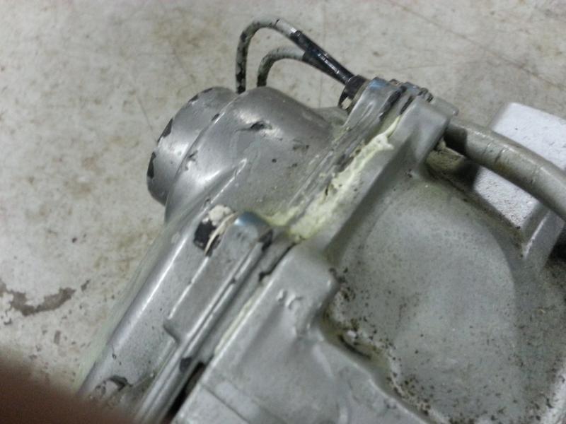

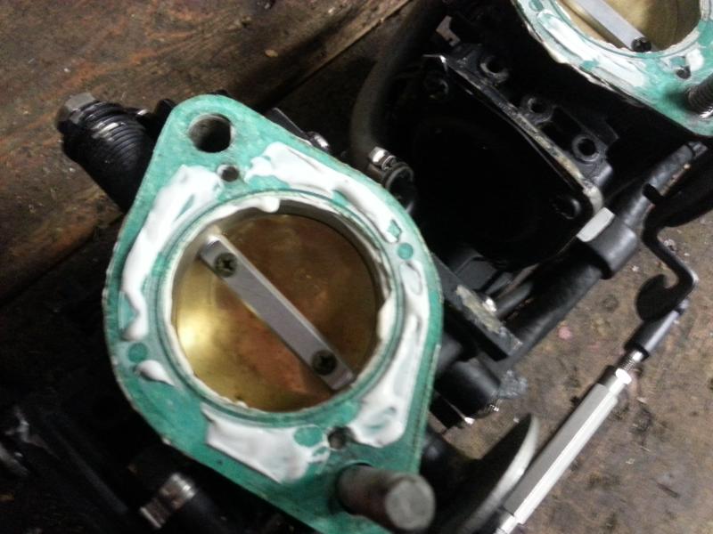

Ok, I talked to my buddy and we can help. Already see some things that are not right. On the mag cover there should not be silicone/sealant there. If the seal was missing/torn it should be replaced. You still have grey fuel lines on the carb. That needs to be replaced. It is probably the reason the motor blew up. The carbs probably need to be cleaned then as well. I wish we could have got to it to powerwash and degrease that hull before you painted it. Plus we would have painted the motor too, but now I would be worried I would scratch your paint. I will call you in a few hours. We are actually going to rewrap a few seadoo seats at the warehouse now.
I'd gut it and do it right, that paint deserves a cleaner hull than that. Also gotta find the cause of the discolored exhaust mani.

um the inside is gross I think you should find out if your buddy aligned the motor when it went in if not take it back out. the inside of that baby needs to match the effort on the out side the old painted oil lines have to go and wile your doing that replace the rest of the hoses and hard ware scrub and do some paint magic on the motor and pipe. this is all just my opinion.

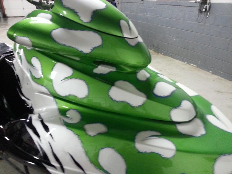

Well we took this project on. Bill dropped it off today. His pictures do not do his paint job justice.

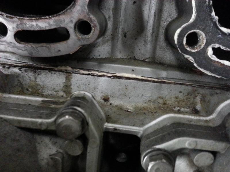

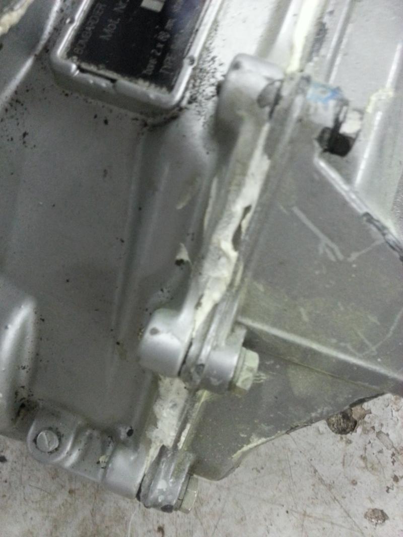

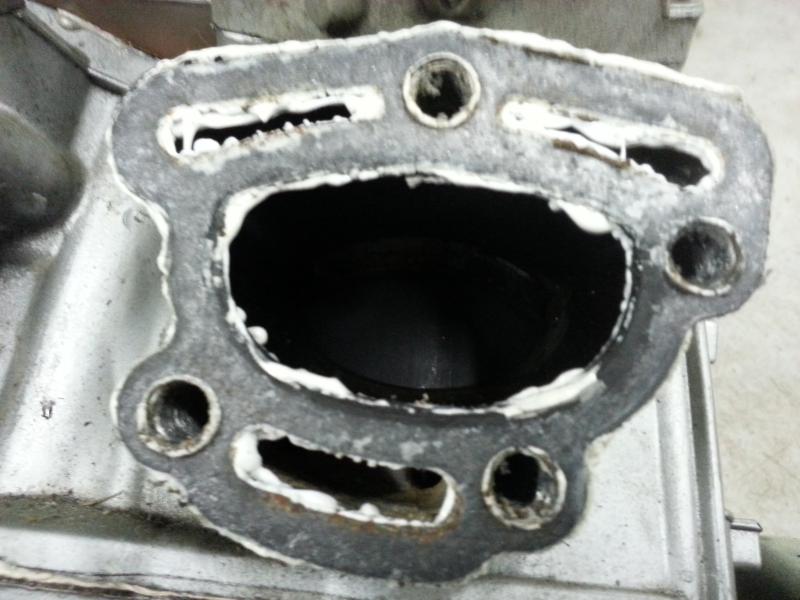

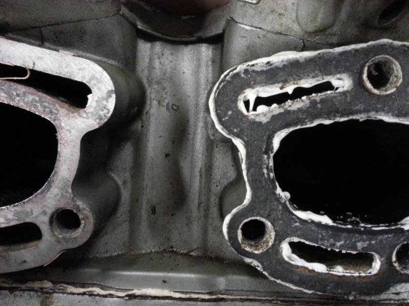

When we were going over it we noticed that whoever put this togethor used a sealant on all the gasket areas. So we are going to pull it apart and clean it all up and reassemble it.

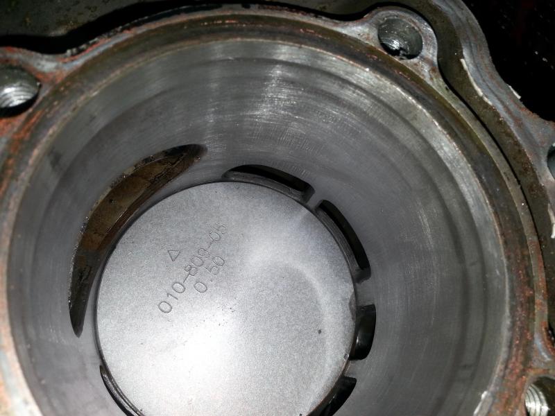

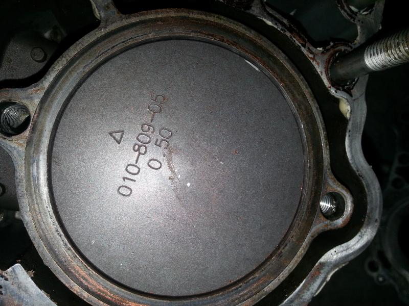

How would you like your water passages to look like this
Pull the head
